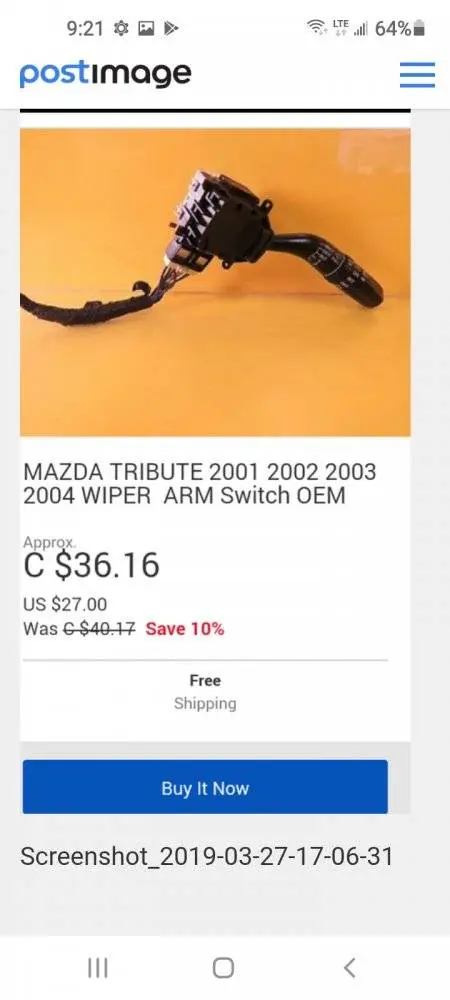

I think that you should get a new signal stalk like I did.
I now have adjustable intermittent timing for my front wipers.
I think that my new wiper stalk came from a Ford Escape 🤔 ...
There's a thread about it (I don't remember where it is).
