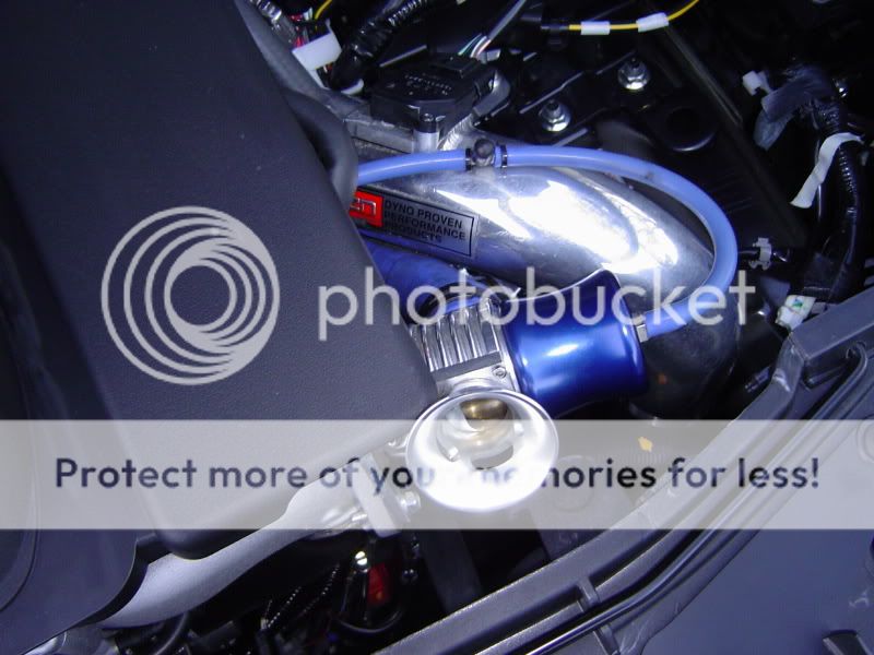

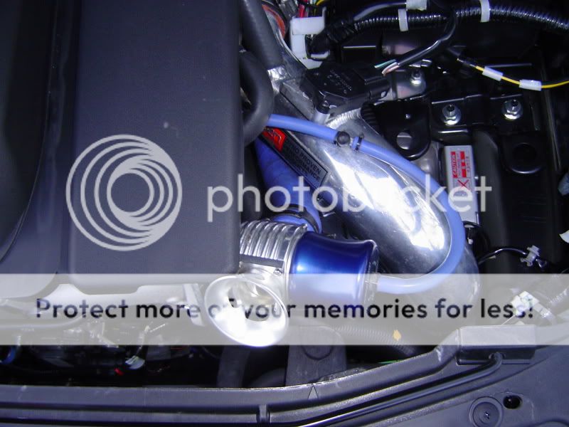

Just installed mine
Pictures of the Fresh install
