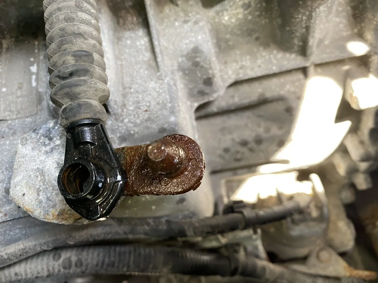

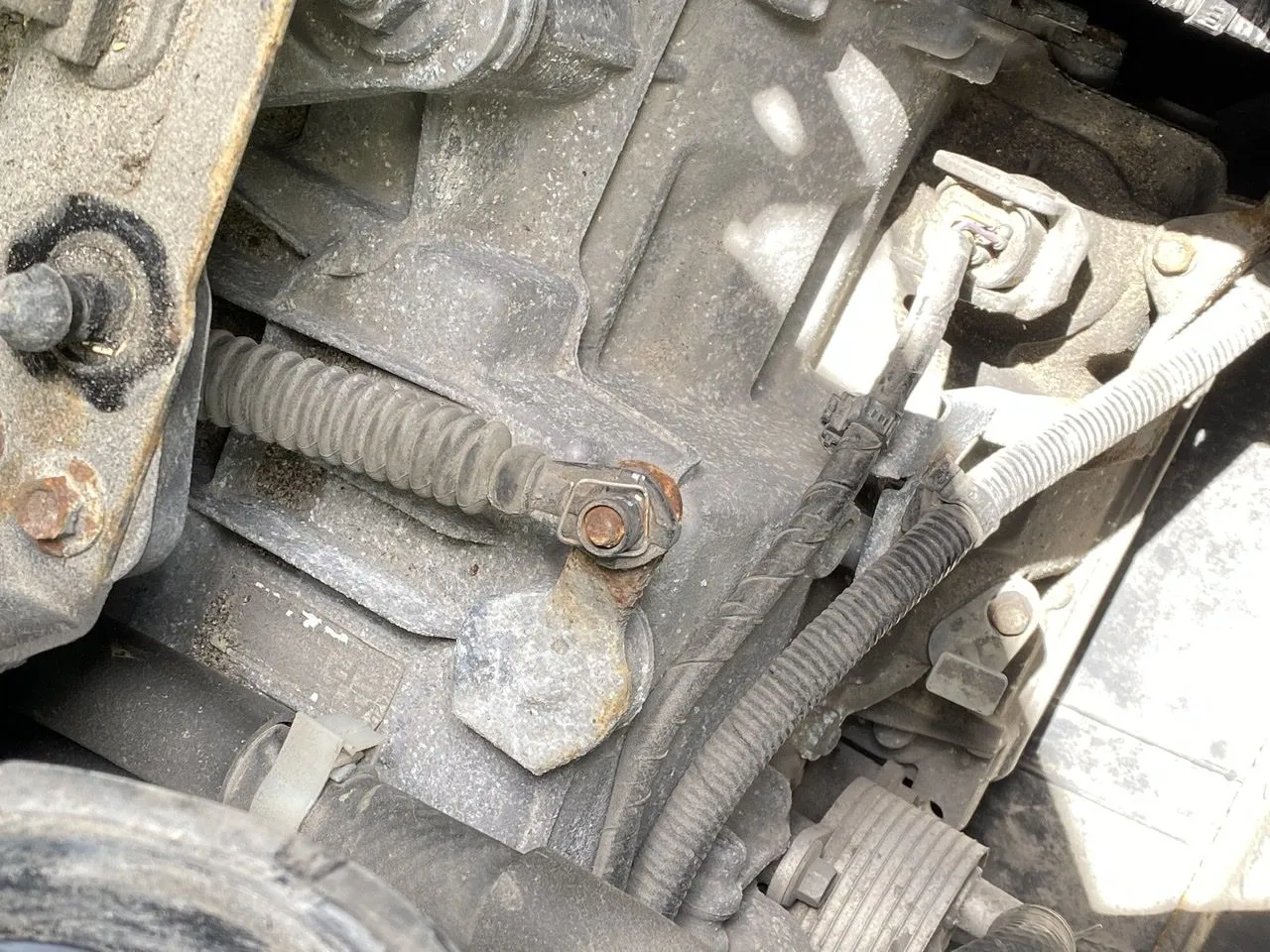

I took a better look at mine today and the issue was actually the shift cable where it connects to a pivot point on the top of the transmission. The lever was corroded which made pivoting difficult.
If you remove two 10mm bolts that holds in the air box and remove the air box assembly you have full access to the area needed. It took some time to get the cable off of the lever, but once I cleaned it up and lubricated it, the car now shifts like it did when new.

Sounds like you saved yourself the cost of a transmission replacement. How often do you hear stories of people fixing their issues by having their mechanic cleaning up a cable? I haven’t heard them yet! Simple stuff like that doesn’t seem to be checked. Nicely done!
The transmission itself was fine so I wouldn’t have had to replace it. However, if left in a corroded state, it could have damaged the cable and likely would have prevented the transmission from shifting into gear.
I have not heard of this issue on any CX-5, but Mazda has been using the same design on many of their models for at least the last two decades and there are plenty of documented issues regarding the shifting cable where it meets the transmission when corrosion is present. Some grease goes a long way in preventing the issue altogether.
I live in Windsor, ON which borders Detroit, so yeah, salted roads are part of life during the winter months. That said, I do have my vehicle corrosion ‘proofed’ annually but they probably can’t reach into such a tight area with their wands.
I presume my issue is due to the age of the vehicle and mileage (313,000km/195,000mi). As CX-5s age, I presume others will report similar issues.
Completely agree. I’m just highly skeptical that my local Mazda dealer would have come to that same (and correct) conclusion.
