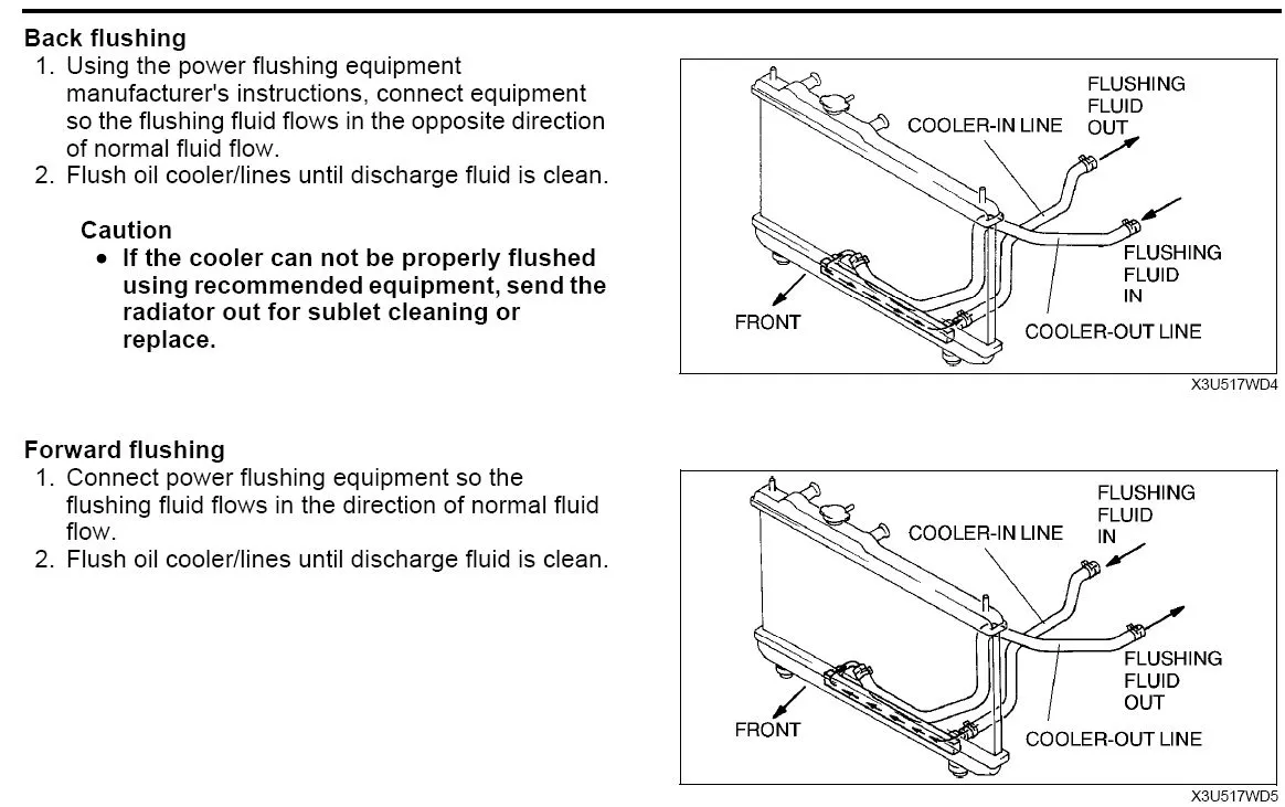

Would you guys recommend this procedure? It's very similiar to the DIY Tranny flush as it was mentioned here. See attachment.
that's the standard procedure for a radiator flush if you have flushing equipment... its what Mazda recommends (as I understand it, though I never intentionally looked into it)
Guess I forgot to mention that it flushed the factory cooler line going through the radiator as well as the hayden transaver 20,000 lb extra oil cooler that I added. I have the cd manual too, been all through it. Didn't say any how-tos were complicated either. It was just more convenient & time saving for me to do what I did & yes time is money & I paid the 35.00 for the convenience, no possibility of a mess in my garage & not having to work around other people's schedules.
