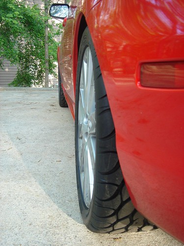

You know most tires these days have rim protectors...which places the edge of the rim in tire; surrounding the edge of the rim with rubber.
Most Falkens and Kumhos have them...
This is a pic from my previous car showing how the Falken Azenis protect the rim...
I also love that look...I hate seeing the rim edge surpass the tire.

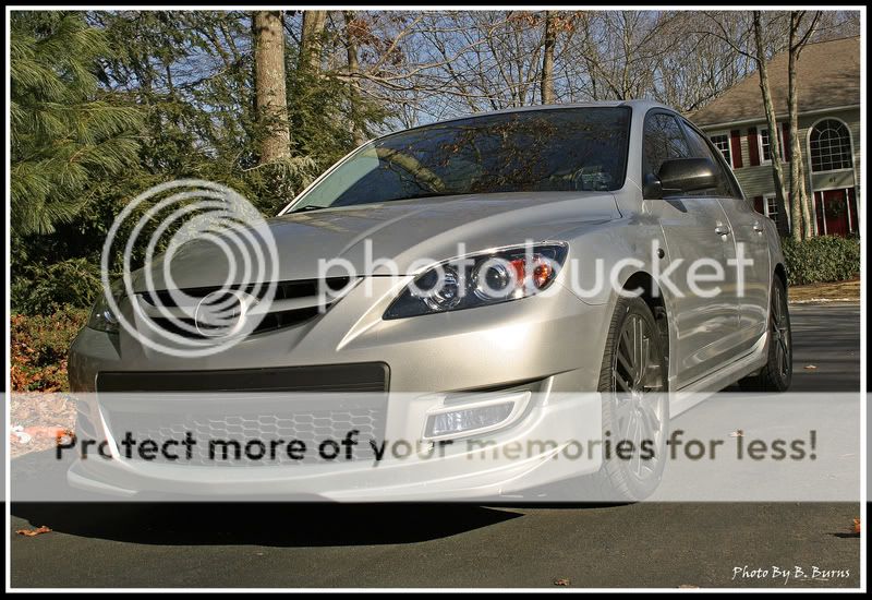

heres 235/40 on stock wheel
Wow, that is not bad... I guess 225 would be fine on the stock wheel.
I was expecting it too puff out more than that. (scratch)

Do you have a side shot of your car with these tires on? I'd like to see what they look like...
not mine, just did a few searches I'll see if I can find more
'northmiller89's car on other forum...maybe hes on this one too?
I have a feeling handling may be compromised a bit the wider tires w/ stock wheels, but it does seem to fit and look fine
