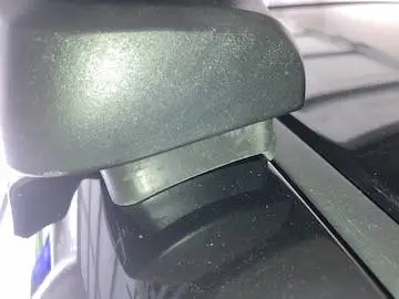

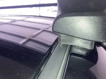

Here's what happened with the front smart-slides at 36 [X] as the manual recommends:
- The rubber feet on the passenger side fits perfectly in the roof rail
- The rubber feet on the driver's side is way short.
The result was the same whether or not the door frame brackets were loose or tightened
The gapping was even worse on the back, and the brackets couldn't reach under the door frame even with them fully loosened.
As an experiment, I added 1/2 a mark to the smart scale in the back, and I'm thinking the front needs the same.
X = 36.5 Y = 35
Those widths have the rubber feet sitting correctly flush.
