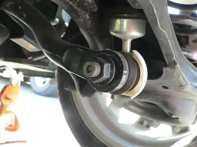

Check the nuts on your rear ARB.
what do i check for when looking at the ARB. And what exactly is the ARB
Look at the picture in my post above. Then look under the back of the car and check the nut. Mine and several other's have been loose, usually the right for some reason.
Rotus8 - Thanks for the photo! I think I'm hearing the same thing and will check mine today..
I had the same problem -- there is a TSB for it -- when I looked it seemed tight, but the dealer said that it was loose and replaced it.
ARB = antisway rear bar or rear sway bar
that is a picture of the rear end link ... ive heard of people having problems of the nut getting loose .. my car was the exact opposite i had a hard time getting it off.
also check the rear sway bar, after i installed mines it was hitting something and i was getting a clunking noise. I looked under and it was hitting something so i just readjust and all was good.
