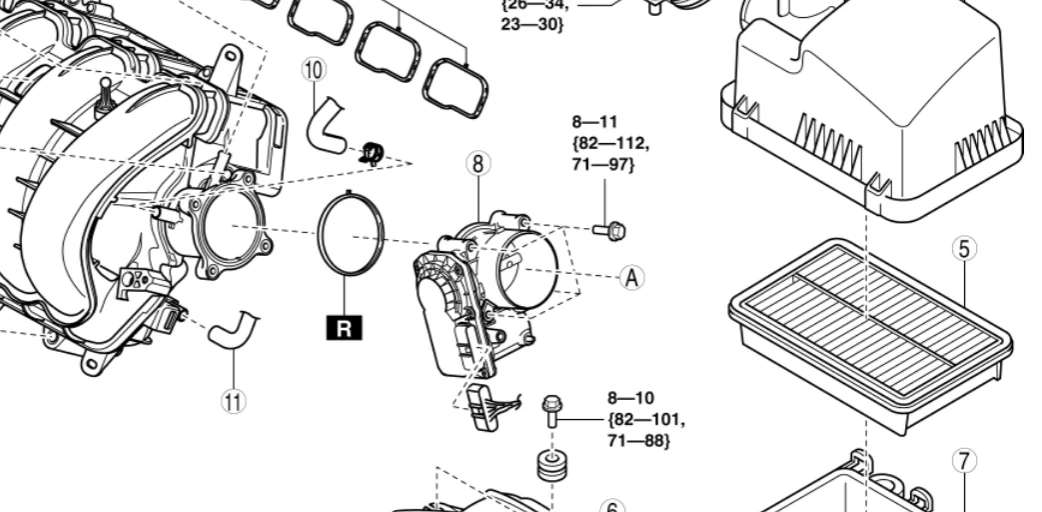

In the service manual, the gasket is specified as a replacement item for any servicing (part #8 in the diagram below). If at 65Kmi and servicing it for the first time, I'd certainly replace it.
Have a 2016.5 CX-5 GT AWD, here, and I've done a cleaning twice, and both times replaced the gasket. Couldn't say whether it's okay to re-use, but the manual indicates it's a replacement item.
