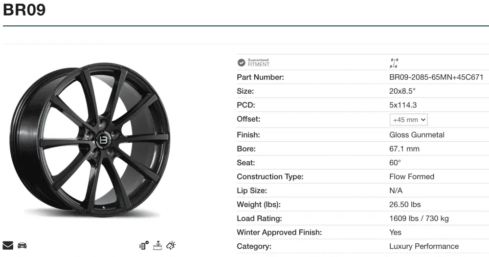

This is the only wheel/rim I find at the moment, which has exactly the same Bore, Offset, PCD, and Size as original OEM 20" wheel, but lighter weight and looks better than M012.
Has anybody bought this rim? I cannot find any actual picture on CX-9, except the composite graph below.
Can the center cap be replaced with Mazda OEM one? I cannot find the center cap diameter of this rim. (The OEM one is 56mm.)
Really love its Bore spec 67.1mm and Offset 45mm. So completely no need for a hub ring or spacer. Happy to keep the same as OEM.
But shipment from Canada to Australia does cost a lot, over $800CAD.
Welcome any ideas about this rim!
