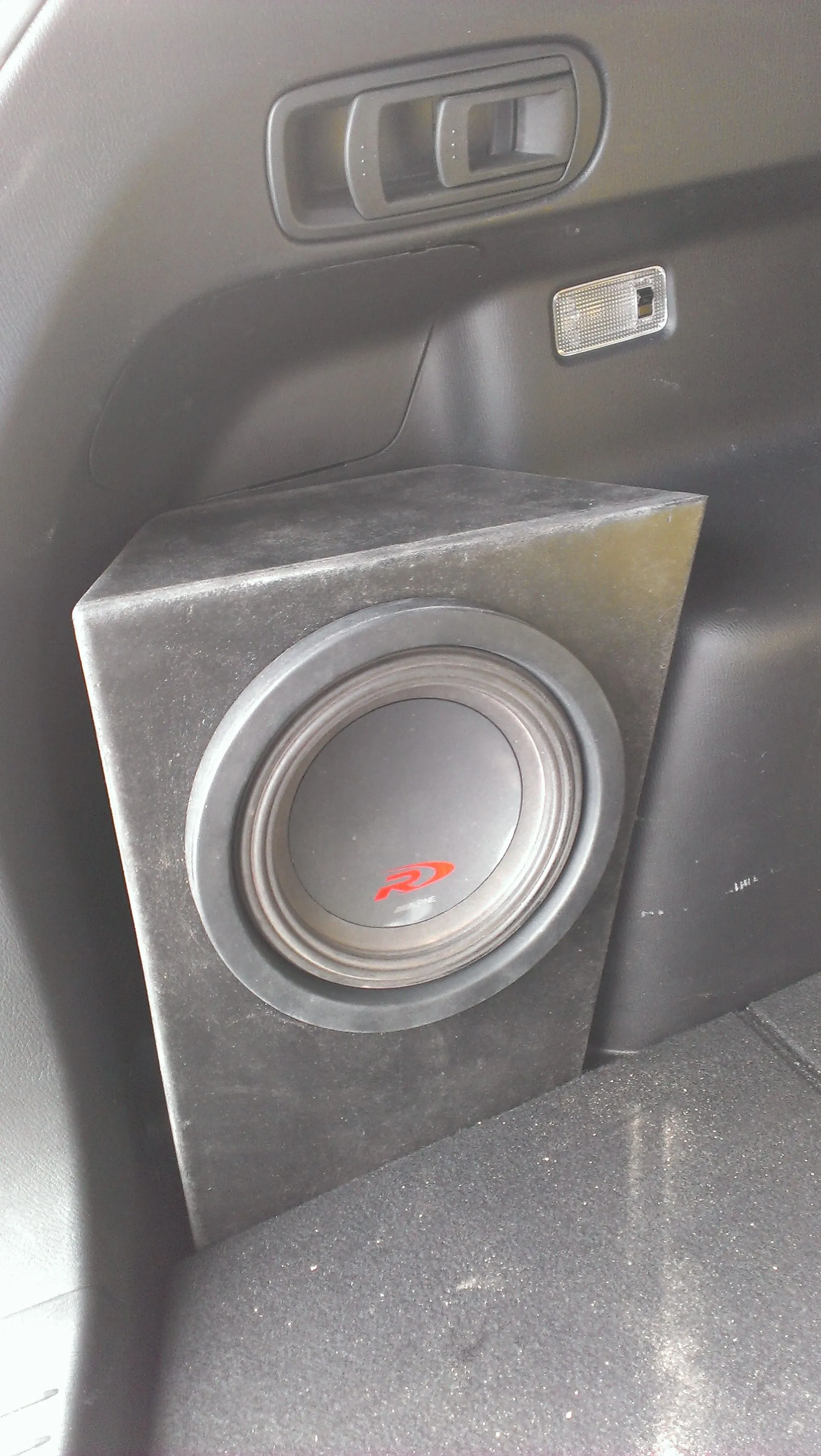

Here's a pic of what I did. I had my system except for the sub installed at a car audio store, and I had asked about the hatch, and he told me not a good idea because of all the added weight, when you try and open and close it it would be a problem. I didn't have him install the sub because he was going to do a fiberglass enclosure and I didn't want to spend he money so had a friend build this box out of MDF. Put in the Alpine 8" Type R because it's not expensive, has really good reviews and works in a very small enclosure. Stuffed it with polyfill and it sounds quite good, never put a sub under the seat but I'm pretty sure this is significantly better. Also, not blocking access to the taillights.

Ah.. the weight on the hatch, very good point. I have a 12 year old Tribute that barely holds up the hatch as it is. And that is a great idea for an enclosure, easily moved if necessary. I'll think about that a little while. I had also thought about incorporating some of the cargo area lighting ideas from the forum into the enclosure as well.
deuce, thanks for that picture. I hadn't run across anything like that before.
Chris, I had seen your setup, and it is a great idea. I'd guess it sounds pretty good, since you have plenty of room for the enclosure and plenty of mass as well. Just in my case, I want to keep a flat bottom to the cargo area, and I'd probably get a lot of residue to fall into the speaker cone.

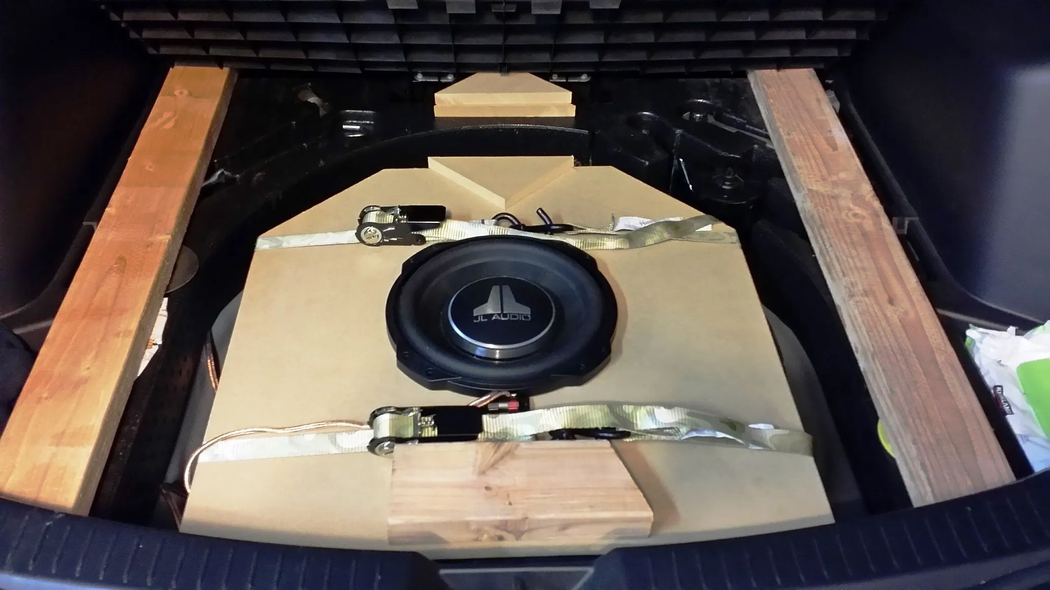

A 10" JL Audio shallow sub, installed in a MFD and strapped to the spare wheel:

Inspired by tibimakai :). Using the spare tyre as a sealed enclosure.
I am wondering whether some holes on the plastic trunk deck which is about 2cm from the subwoofer paper cone are required for the bass to come out or not?

Nice setup you have there. How do you seal it, against the steel wheel?
Believe me, the sound will come out, you don't have to worry about that.
Initially, I was thinking about drilling a couple of holes in the steel wheel itself, to mount the top cover. I don't see a problem with that.
I have used straps, to test it out, but I ended up leaving it that way. I won't be going to shows with it, so I don't mind the look.

I have get rid of the plastic nut, because it is to tall. I have used a regular hex head screw. I have also added a wrench in my trunk, just in case, that I have to remove my wheel.
I'm surprised, that not to many go this route.
