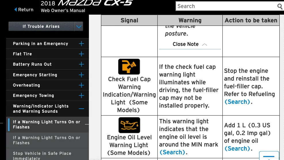

Are you sure the warning light is for low oil? I think it is likely a low oil pressure indicator which low oil is only one of the possible problems...
@GAXIBM please check the picture I posted up there at post
then compare that to the owner's manual (page 4-25)
and page 7-33
oh and don't like the PDF? try the interactive version of the owner's manual here:
long story short.. yes this is oil LEVEL -- not oil PRESSURE warning symbol. As previously indicated the oil level was found to be at the first dip stick dot; then oil was added (3/4 quart) and found to be just below the 2nd dip stick dot.
