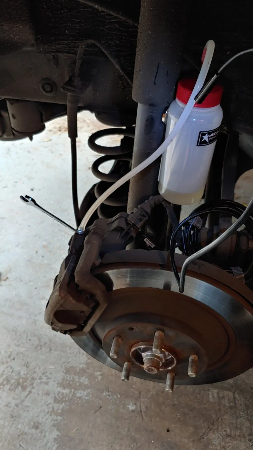

Just curious, which method (or tools) do you use to replace the brake fluid? I stilly use old-fashioned 2-man pumping the brake pedal method but that requires my wife is in a good mood ⋯ ;)
I'm going to do the 1-person pump with tube submerged in elevated bottle of brake fluid. With my previous cars I've used speed-bleeder nipples that had a check valve in each, but they don't seem to have them to fit the CX-5.
I have a bluetooth camera I'll set up so I can watch from the driver's seat, so I should be able to see if there are bubbles and when the fluid runs clear.
Setup:
Bluetooth Camera View:
