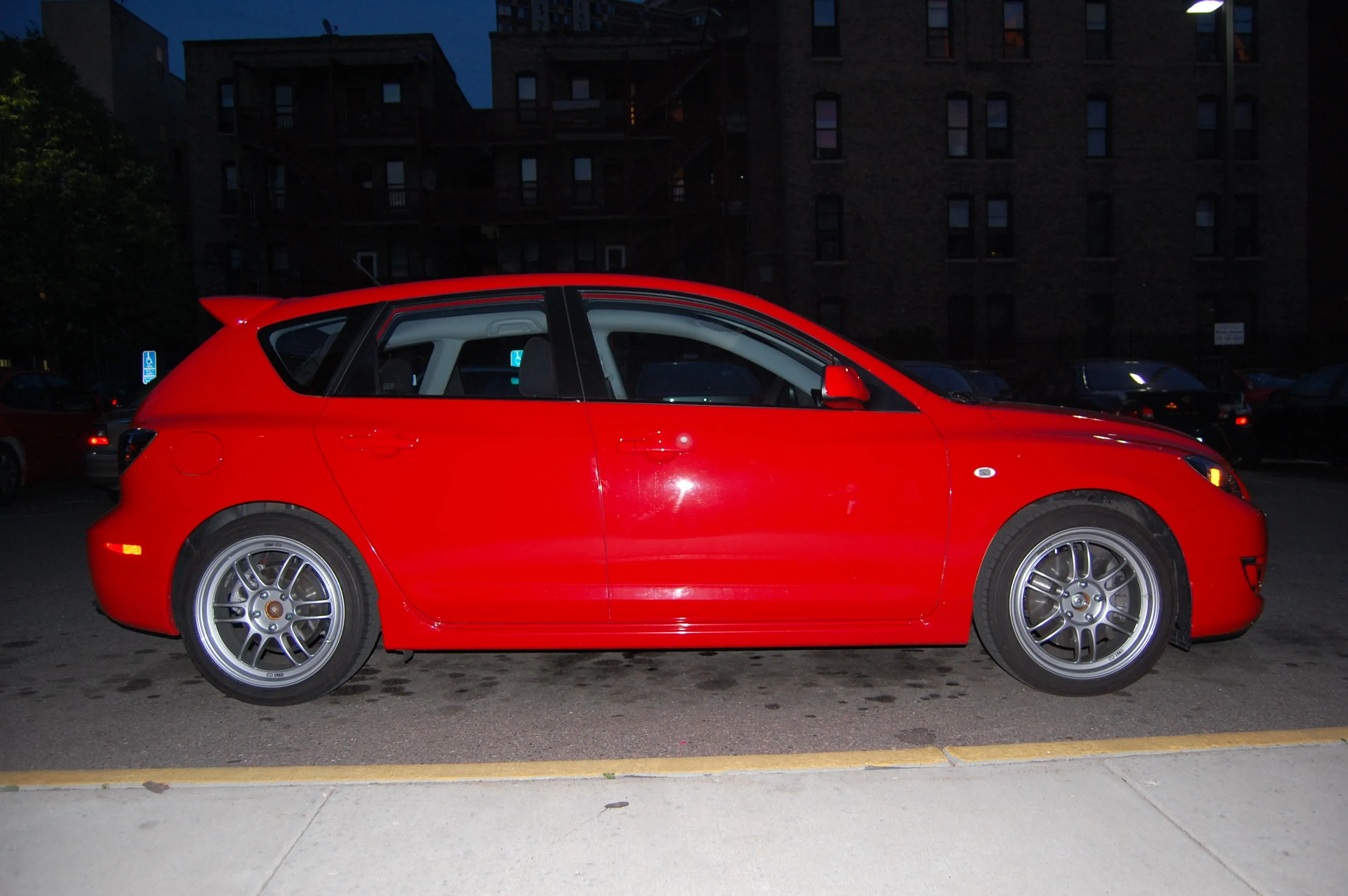

I did. Weighed both a stocker and an RX-8 on a calibrated digital scale when I was swapping wheels.
Stocker = 24 lbs
RX-8 = 22 lbs
RPF1's

i have RPF1's too and i could tell a difference form stock when i put them on. the car lost traction a lot more when hitting boost in 1st and 2nd.
