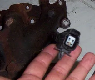

Run the car up to normal driving temps (sensor needs to be heated), stop the car...disconnect the o2 sensor from the main wires on the engine bay (i would stall the car and start it with the sensor disconnected).
Start the car, and use the voltimeter to see what voltage the o2 sensor is sending right there.
Also, do not use the wire-clamps that comes with the FM kit, SOLDER IT.
i dont understand what youre saying about the o2...i tested the o2 and got .02v. if i disconnect the sensor how am i going to test the voltage? i have a little butt connector that my multimeter lead fits into perfectly for testing the voltage on the blue wire from the first o2 sensor (which becomes the pink blue after the harness)
sorry its my english...
with the engine running idle...
test it right here (refer to picture)
