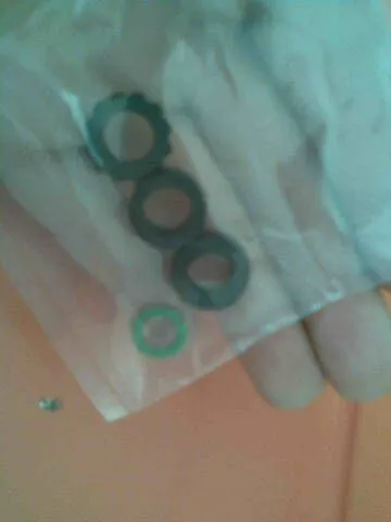

you cannot use off the shelf orings for the injectors to head. these are thick plastic rings with rubber grips inset which can only be had from mazda.
I bought a kit from a local parts store that had them in it. They were same thickness, hard plastic with rubber ridged grip insert. Looked exactly like the oem counterpart.. why wouldn't it work?

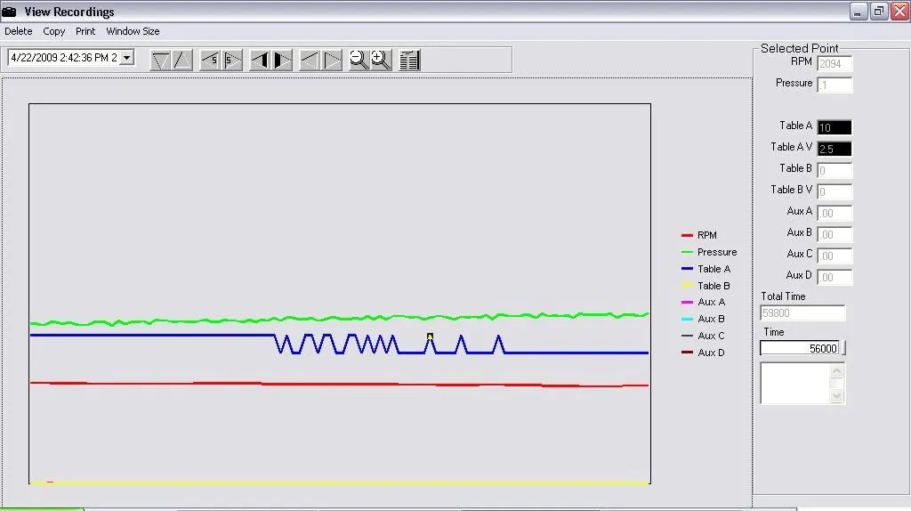

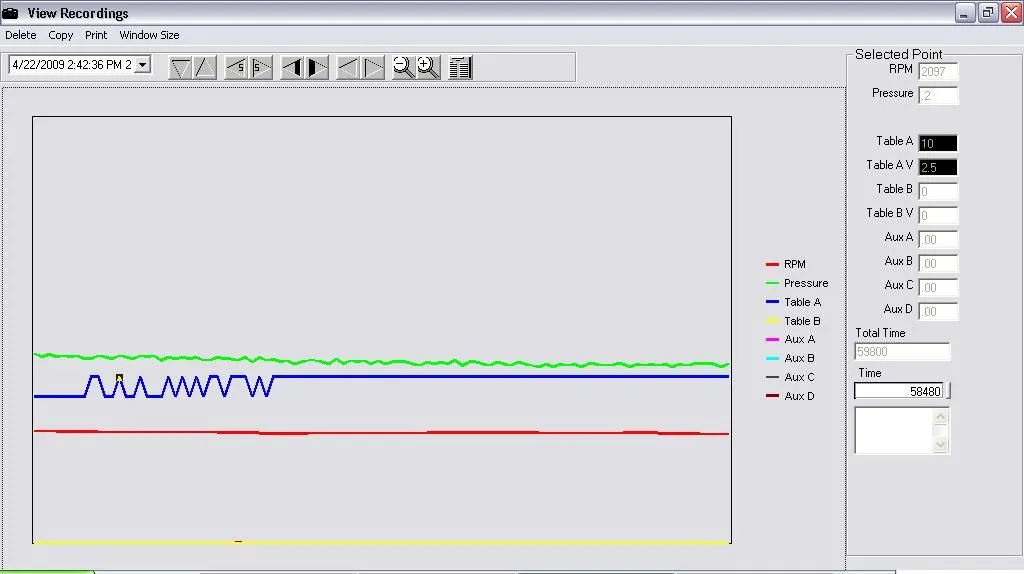

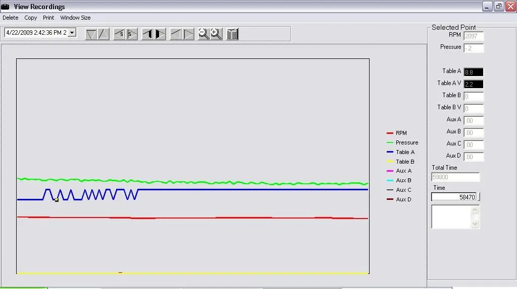

Here are 2 areas from a spot I recorded last week showing how it spiked switching back and forth. Is it normal? I'm not sure what it means jumping from 2.2 to 2.5.
i was thinking of something else entirely then, my bad. i've never seen these in a parts store :( just generic donuts
The box came with 4 pieces. Its called "fuel injectors component kit" it came with 4 pieces. The top o ring, the thicker one thats recessed in the middle on top of the injector and below the o ring and the bottom insulator with the ribbed rubber insert, plus another one that looks like the insulator but its one piece and smooth.
I'll snap pictures when I buy more kits to replace all the injectors.

picture of the ring kit
