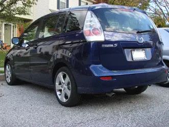

Did you ever get this issue resolved? I am also looking into getting them on a 5 without sills. I too feel like the only person who does not like them on their car. I was afraid of scraping the underside on speed bumps so I opted to get the model w/o. Any pics of your install would be appreciated. Did you get them intsalled in the rear also?

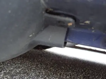

Here are pics of our side sill-less, spoiler-less 5, complete with splash guards. You'll note that the back of the splash guard is not fastened to the body of the car. The instructions say you have to unbolt part of a stone guard and cut a section off with a knife--but I don't see the stone guard they're talking about. Then they say to pop an anchor into one of the pre-existing hole, which is there, but is covered by a piece of flush-fitting plastic. Taking that plastic piece out leaves metal exposed, which I wasn't too thrilled about, and it still doesn't fit well--note that the splash guard doesn't fit flush. So I left the plastic piece in place and left the back of the splash guard unattached.
So far it's okay--there are three screws that anchor the splash guard to the wheel well, and so far they've held okay there. But the splash guards are a major disappointment compared to how easy front and rear splash guards fit to my Protege.

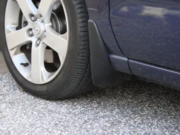

You're right about the stoneguard. Looks like I don't have it either. I'm installing my guards later. Will let you know how it goes. As to the plastic plug, it's all good. It's not bare metal anyway, it's treated. I tested one mounting plug and it fits perfectly.
Pics
That was an easy install. Took around 20 mins. tops. Since we don't have the rock guard, I delted the extra plastic piece from underneath. All it was really was a piece to clear the said guard.All in all, a great fit and nice addition to the 5.
Here are the pics:
While I was changing my oil, I noticed that the white plastic piece that plugs into the hole popped out in both guards. I'm guessing it came off when I drove the car into the snow a few days ago. I pressed the white piece back into the hole again. I'll check again in a few weeks if it pops out again.
