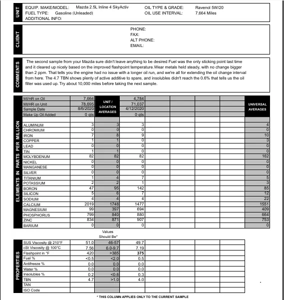

As promised, just received the oil report from Blackstone this afternoon.
Came out great for 7664 mi, I usually don't go much more than this on my vehicles.
A little interesting in the way the comments were written, this time I ran the car for 45 min then left it sit for half hour or so to cool then changed oil, probably why fuel dilution disappeared this time.
Oil used was Ravenol 5w20 SFE.
Blackstone is well known as unreliable source for fuel dilution checks. There are references that they basically derive fuel dilution from flashpoint test. You can just ignore it and if you smell gas in oil - send it to Oil Analyzers. Please see my experience below:
Post showing differences between OilAnalyzers and Blackstone for oil dilution
However, by looking at mileage and viscosity - you are probably fine :)

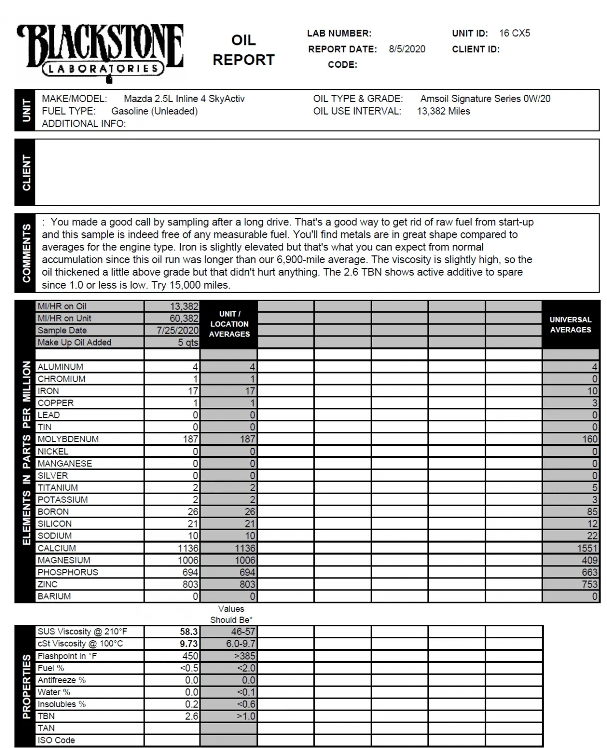

Hey Guys,
Here is my oil analysis from my 16.5 CX-5 with 63k miles currently. I also posted this on BITOG
I'm hoping to run the Mobil M1-108A till it's approximately 18-19k miles before doing another analysis to see how the AMSOIL Signature 0W-20 is performing. Also, to clarify, I did not add any make up oil, I simply misread the question as "How much oil did you add into the engine after the change?"
7/25/20 (OLD) Setup:
Oil Used:
Filter Used: AMSOIL EA15K12-EA
7/25/20 (NEW) Setup:
Oil Used:
Filter Used: Mobil 1 M1-108A Extended Performance Oil Filter
I don't like that it thickened.

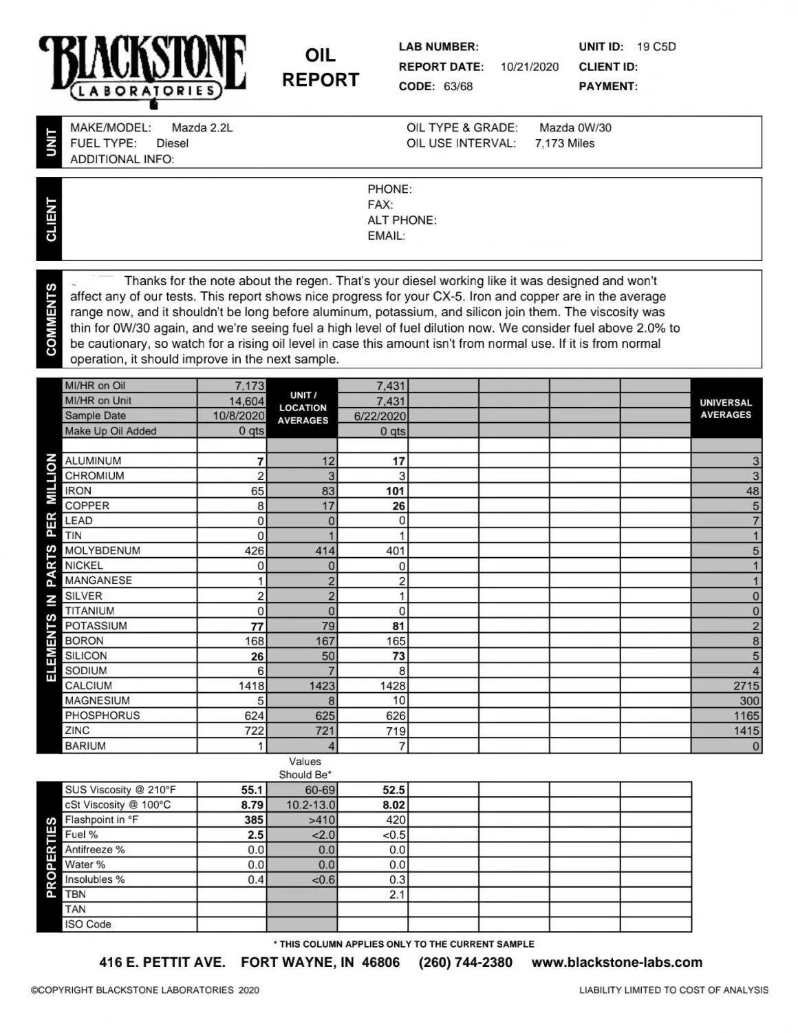

UOA report in from 2nd oil change on the 2019 diesel. The car happened to do a DPF regeneration cycle on the way home from work that day and finished just a few miles from home so I anticipated that there would be some fuel dilution and a lower flash point in this sample. No change in oil level throughout this run. Viscosity still shows low (but higher than last report) with this Mazda 0w30 diesel oil.

I would suggest to change your oil earlier (say 5000 miles) if you want to have many long years with the disel and change air filter every 2nd oil change. Especially if more of the driving is non higheway.
Good diesel fuel is a must as well, not sure how good US diesel is though for direct injection high pressure diesels in normal cars. the diesel has a fuel filter as well (cartridge) that is consumable.
The regen is done with the adblue or whatever mazda calls it not directly with more fuel. Basically inducing adblue and getting very high temp in the dpf to burn the soot that accumulates in it. Its all in the exhaust system. Bear in mind if you drive mostly in city more regens may happen and you may need more adblue sooner than later.
I also think you should have changed the first oil earlier to get all the metal crap parts out quicker.
What kills a lot of the disel cx5 engines in europe is the long oil change intervals and crappy oil and other diesel related crap that clogs the oil pump and the jets for the oil sprays on the bottom part of the engine eventually. Then no oil lubrication and things go south over time.
Actually, the Diesel Particulate Filter (DPF) regeneration cycle ("regen") IS assisted by using more fuel in a "post injection strategy" to increase the Exhaust Gas Temperature (EGT) in an active regen. Some of that fuel ends up sticking to the cylinder walls due to the lower pressures/temperatures of the injection timing and then ends up making it's way past the rings and into the sump. Much of the fuel dilution in the oil "burns off" or evaporates after some time (depending on oil temperature and engine rpm). This phenomenon is why the fact that my car had just finished a regen cycle only a few miles before the sample was taken is a factor with the fuel dilution for this sample.
The DPF is the first thing downstream of the turbo (actually just behind the engine). The Selective Catalytic Reduction (SCR) is the gizmo that uses the Diesel Exhaust Fluid (DEF or "AdBlue") and is downstream of the DPF. It uses the DEF in a catalytic converter to reduce oxides of nitrogen during certain engine operating conditions (usually extended low speed/idle and high engine load conditions). The SCR may use more DEF when an active regen is going on, but it's a separate, downstream event that doesn't help clean the DPF. DEF cleans Nox out of the air, not Particulate Matter (PM) out of the DPF

Yes, DPF regen does burn more fuel and bring down the fuel efficiency.
