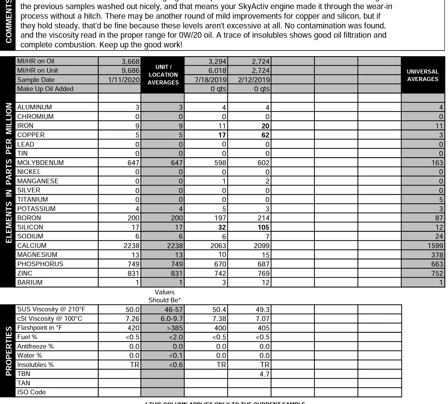

My latest report. They recommend going 10K miles. Not sure if I want to go that long or not.
Savageese a YT reviewer sent his factory oil on his Mazda3 for analysis and blackstone recommended 15K miles for him. I am sticking at 7500-8500 miles. My last OC was at a dealer without moly and man their oil sucked. Its been only a day on mobil1 and its a world of difference. One day in the future at 80-100K miles I will switch to 10 - 12K miles per OC. That would be sweet.

A dedicated thread was mentioned for oil analysis tests so I will start this thread off with mine. I realize there are numerous other threads with oil reports. Hopefully this one will be easier to find.
Just came in about 10 minutes ago.
Looks overall good to me
What are thoughts on the higher viscosity?
I did change on cold motor and at around 1/3 of a drain I took sample

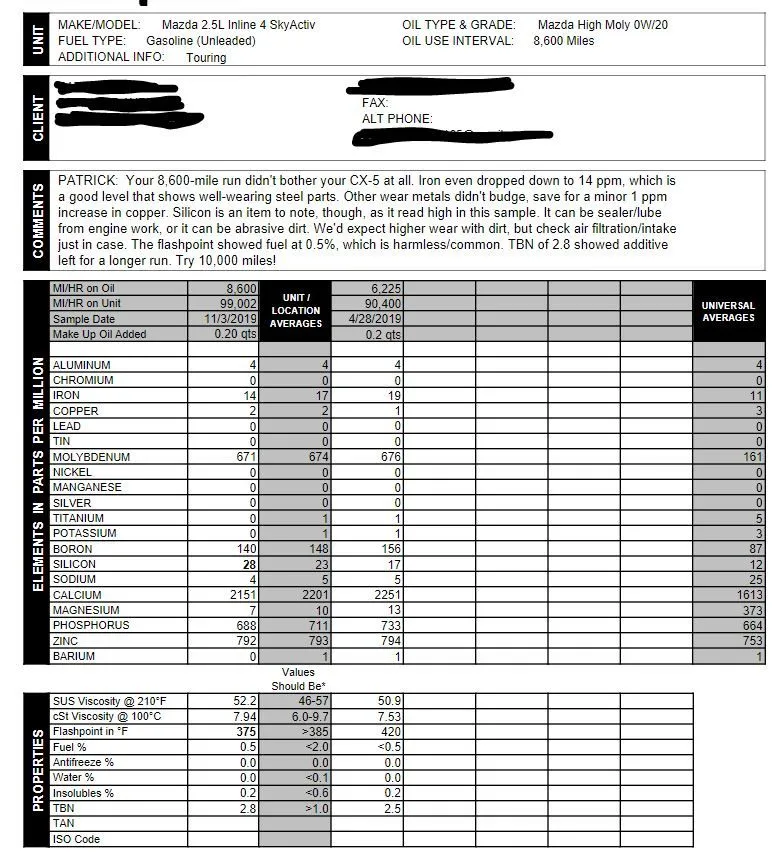

my latest report.
Mazda moly 0w20. 2.5NA
The oil did great given the fact this was driven in constant 110F and high loads this summer in Arizona.
CX5 GT
I do it every 6 mo because I dont make many miles and also live in a very dusty and very hot summer climate.
10k would be more than 1 year for me but I agree with all of you that this oil is very capable.
