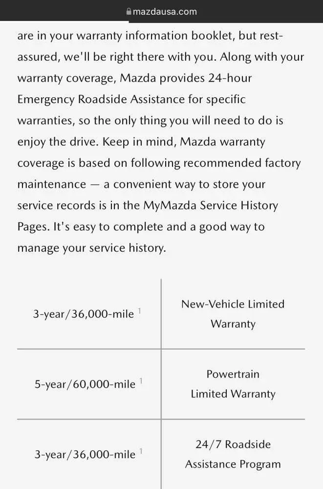

Powertrain warranty on an 18 is 5/60. Bumper to bumper is 3/36.
CX5 GT

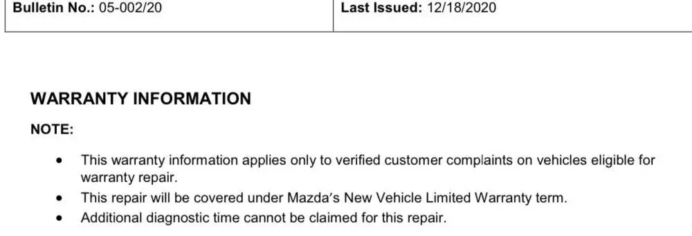

not covered for free after 3/36 according to the tsb.
Phoenix
2021 signature
What am I missing? Where does the above say that indicates that a power train issue isn't covered up to 5yr/60k
CX5 GT
there are different warranties.
There is also the Federal emission warranty on top of the above. Different repairs are covered under different warranty per Mazda discretion and are mentioned in each TSB explicitly.
All the rest is good will more or less whether by the dealer or Mazda US Corporate.

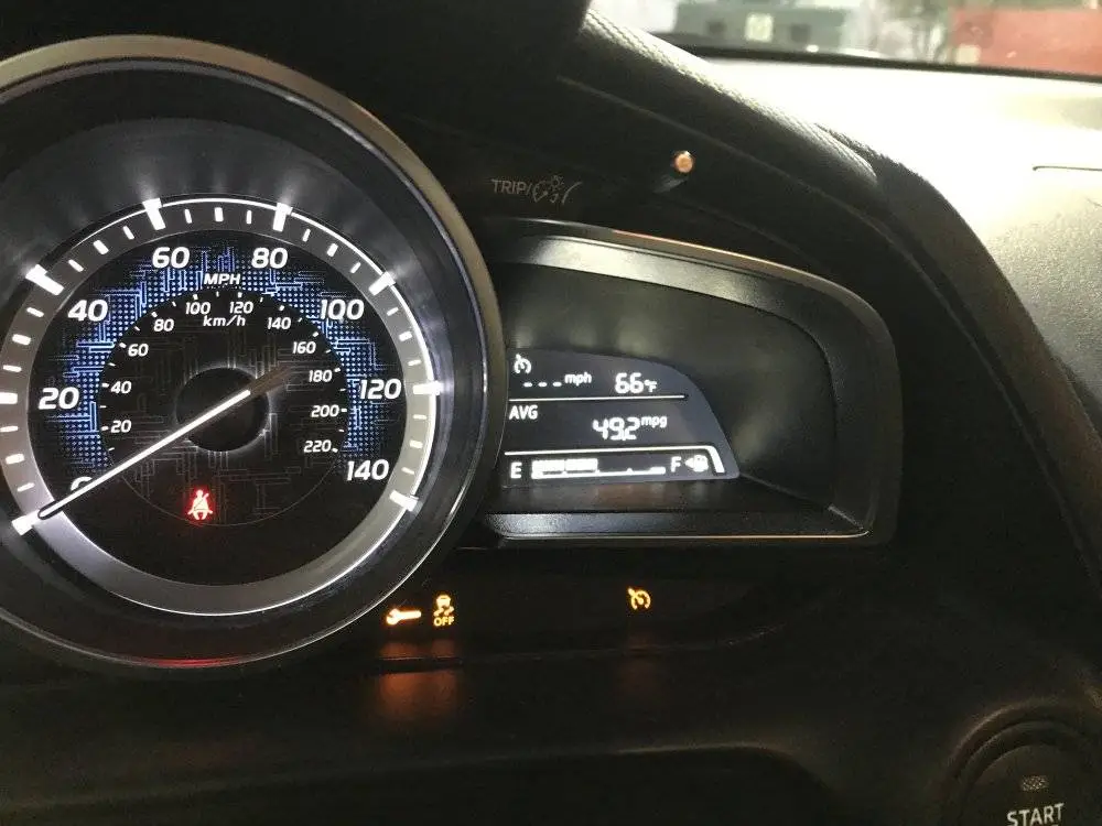

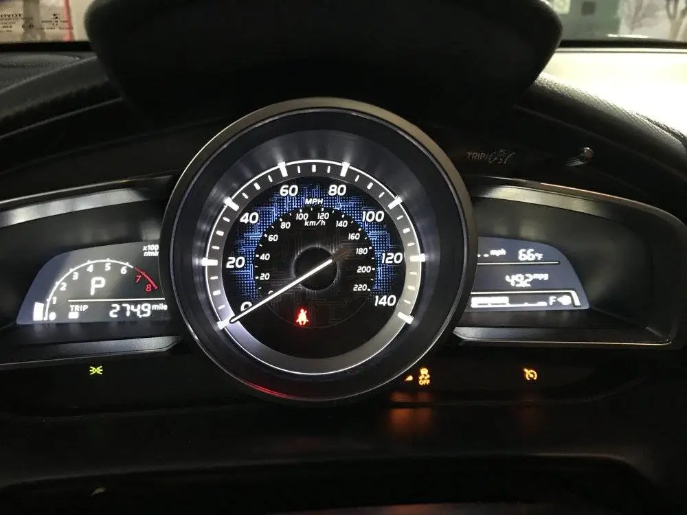

During the Thanksgiving Holiday we drove our 2018 Toyota Yaris iA (Mazda2 in disguise) from San Jose to LA Norwalk for 355 miles one way. I totally forgot to turn the TCS off and once we got to LA Norwalk and filled up the gas again at Costco which always has very long line waiting in California, I checked the AVG MPG info display which hasn’t been reset for a long time, 38.4, increased from 37.8 a bit at the Costco gas station in San Jose just before the trip.
On the way back yesterday I turned the TCS off the Yaris definitely behaves just like our CX-5, the car feels peppier which makes me believe the gas mileage should be improved. Wife drove the first part and I could hear the engine was roaring a lot in the mountain section on I-5 north of the LA. We stopped at the first rest area and I started to drive. I saw the AVG MPG showed only 36 which is worse than I expected. I immediately noticed the “SPROT” amber light was on in dash, and that’s why the engine revved very high in 4th or 5th gear even at 70+ mph! I turned the Sport mode and TCS off、reset the AVG MPG、and drove the next 200 miles. Even though there was a 40 minutes of stop-and-go traffic on I-5 due to a car accident, but when we stopped at the rest area and I checked the AVG MPG, I was shocked to see:
We can see the “TCS OFF” icon is on in dash, but I’ve never seen such diesel like average MPG before, 49.2!
When we got to Costco gas station in San Jose after some mountain road driving on Hwy. 152, the Avg. MPG display still showed 46.0, and we drove 70~80 mph whenever possible, didn’t slow down trying to get better gas mileage.
The MPG calculation based on gas pump is 41.3 from SJ to LA with TCS on, 43.3 from LA to SJ with TCS off (but about driving with “Sport” mode on). I’m totally convinced turning the TCS off on Mazda vehicles somehow makes the engine peppier and more efficient (or less unnecessary braking by TCS), hence improves gas mileage significantly!
View attachment 305063 View attachment 305062
If I understand this correctly, you got MPG display readings of 49.2 and 46.0, much higher than your manual calculations. This goes to show how inaccurate the MPG displays happen to be, frequently reported by folks who do manual calculations.
My dash reading overstated the MPGs by 2.5 on my last tank when compared to a manual calculation. I could even see it coming--at half a tank with 200 miles on the trip meter the 28.8 displayed was an overstatement. Unlike you I get more accurate readings the more expressway miles are driven on a tank of gas.
So, your manual calculations show a 2.0 difference with some additional adjustment required for the 1/5 Sport mode miles. This could be accounted for by driving in different directions. A 15 mph headwind vs. tailwind alone could account for the 2.0 difference. Is one direction more uphill and the other more downhill for some additional incremental difference? I would not draw firm conclusions based on the facts presented.
In my tests I agree the vehicle seems somewhat peppier with TCF off--slightly less gas pedal pressure to get the same result. When adjusting for pedal pressure the vehicle performs the same in acceleration and shifting behavior. This would lead one to think that TCS is using less gas. On the other hand, these test were done on flat, smooth roads in a straight line with 12,000 miles on the tires, plenty of tread. It's hard to believe even a hypersensitive TCS is engaging. Though hard to believe, It could be TCS off adjusts throttle body behavior while still pushing the same amount of gas. With interconnected complexity of the various systems I wouldn't rule it out.
