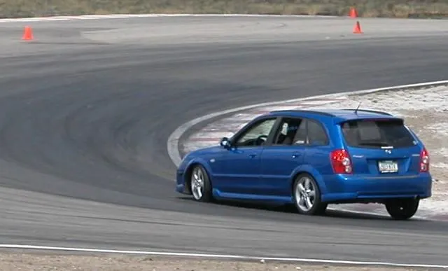

Stock will last a while. I have been lowered on Eibach's since about 5 thousand miles with stock struts. I now have over 97 thousand on the stock struts and that includes hundreds of hard mountain driving plus track time on Firebird International Raceway, ButtonWillow Raceway and also the track from Protege Fest back in 2004.
