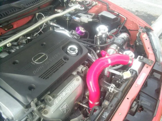

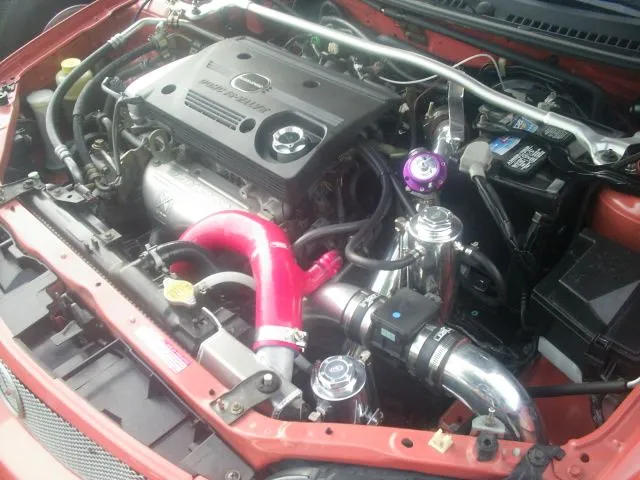

Hey ALL,
Anybody have the blue Samco silicone hot pipe installed on their MSP, with an after arket BOV? I have a Greddy Type S, and I want to buy the Samco pipe, but I only see a small nipple for the Stock BOV....help! I ordered a cold pipe with a flange so I can bolt my type s on the cold pipe (i currently have the BOV on the hot pipe).....heeellp! Thanks!

Right but I dont have a dual setup. Is it possible to have a sealed samco pipe. Then on the cold pipe, have the Greddy BOV, venting? I threw away the stock BPV...
I'm sure you can find either a stocker for $20 or so on here. Or you could plug the samco and see IF it works well.

Right, thats what i was plannin on doing. CAN ANYONE HELP verify if plugging the Samco hot pipe will WORK!!? HEEELP!
Yeah you can try and plug it and because it does have a pice of metal it should be easy to clamp down on it good but you will stall. Read up on the dual bpv/bov set up, a lot of people are running this set up because of the stalling. Why don't you get a Forge BPV and run also a BOV with the forge it wil be able to hold a bit more boost easily.

forge bpv? yea i want to do the dual valve setup, im missing the bpv though....anyone know someone with a stock bpv?
hey all, just wanted to update that plugging the samco flange will work since i do not have a bpv. Ordered the Boostsciences Reflex BPV....on the way to do the dual valve setup.
