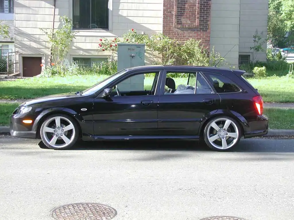

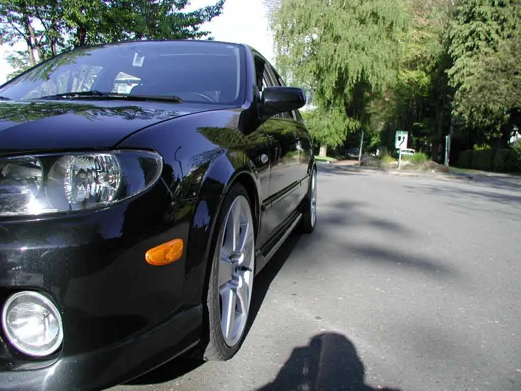

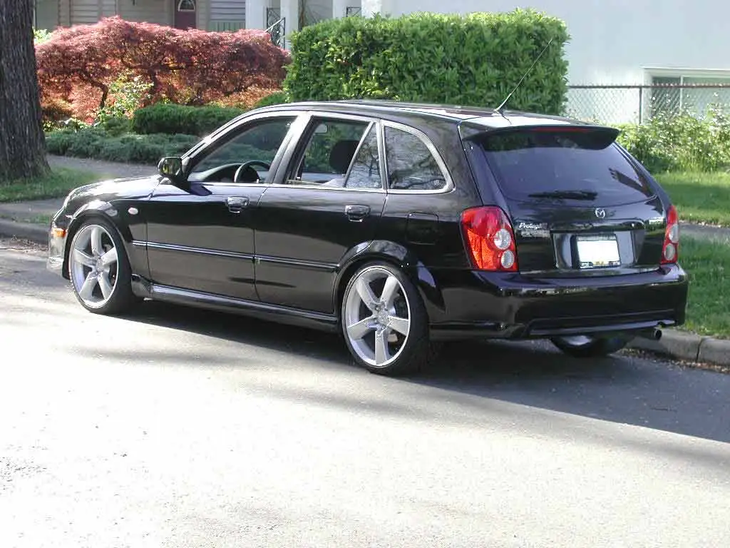

I know these wheels will fit because someone on Toprotege has them on his, but I have some questions about how he's mounted them, and that board won't let me post. I'm hoping some members of that board actually post up here as well.
I know he's using wheels spacers, but in the thread at toportege its stated he's doing it to fill out the wheel wells a little more. From the photos, its looks like only the rears are spaced out, not the fronts, is that true? I can see the wheel spacers on the rear in the close up, but don't see them up front, and the side views look like the car is staggered. I'm just curious if this is done strictly for looks, or if the wheels will rub in the rear inside if they aren't spaced out. From the width/offset, its the inside that's really close on the P5.

The wheels are all 18x8, with a 50mm offset, the distance from the outside of the rim to our fenders is only 1mm more than a 18x7.5, its the inside where the extra 1/2" of rim width sits. I'm just wondering if it will hit something on the inside rears, hence why he put the spacers back there only.
I'm also not positive its staggered, just from the photos that's the way it seems, maybe all four have spacers and they are required, I just hope I can find out asap.

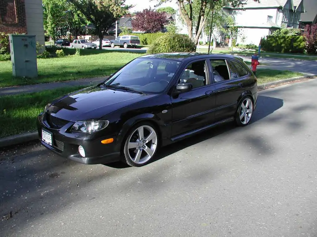

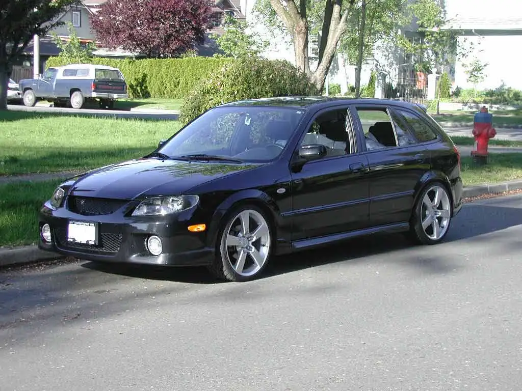

They rub a bit on bumps in the back, just need to roll the fender a touch. Unlowered, they'd fit fine, add that to the recipe Rishie!

Eibach sedan springs, so the rear is lowered more that with P5 springs.

I have no rubbing lock to lock on the fronts? The only time the fronts touch is going down into my underground parking and turning at the same time, it hits when the transition from downhill to flat while turning, but that's it. OUtside, flatground I get nothing?
