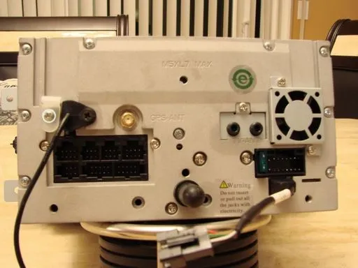

The above picture shows you the back of Caska (Rosen). Only one factory harness goes into the Caska. All 7 slots on the left require splicing. Cutting factory wires is must because this unit is not plug-n-play. Despite all the quality issue I had to deal with the Caska manufacture, I just don't see the benefit to purchase this unit.
However, if your CX-9 is running out of warranty and without the oem gadgets like my loaded GT, it might be worth to try this unit. It does provide you the functional INFO and steering wheel control buttons.

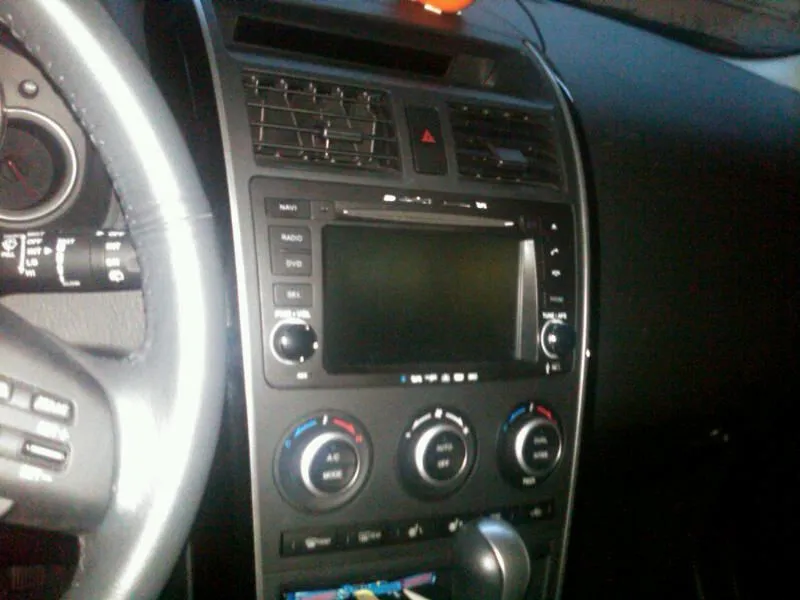

For mother's day, I installed similar GPS unit from CA seller but made in China unit.
http://cgi.ebay.com/07-11-MAZDA-CX-...=0&customid=link&campid=&toolid=20001&mkevt=1
(I have no connection to this seller)
I had to replace the original unit with repalcement as the original unit could not find the GPS device.
Since seller is based on California, replacement unit came quick.
Standard all in one unit.
GPS (IGo8), DVD, all media player, SD, USB, Rear Camera connection, etc.
Overall, I am happy. (actually my wife) and looks factory.
Sorry for the low quality phone camera picture.
Thanks

Does the unit use the Factory wiring harness?
Do you still have all the functionality of the upper display? Time MPG..
Do you have steering wheel control?
I got these answers in PM from him.
Does use the factory harness
No control of upper display.
Steering wheel controls all work except the Bluetooth buttons.
