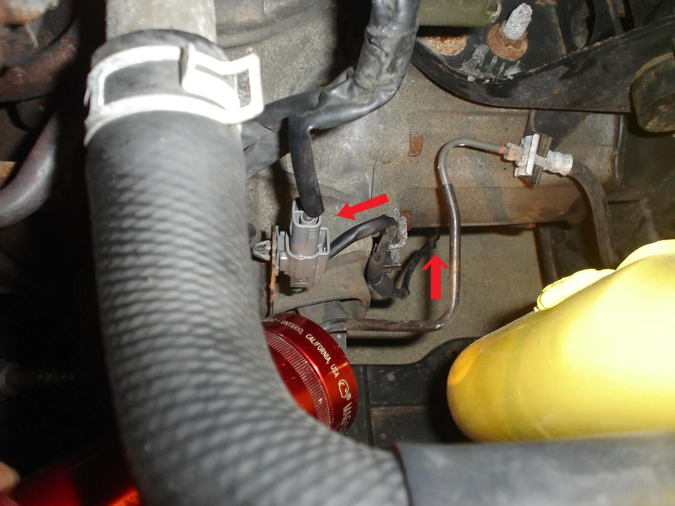

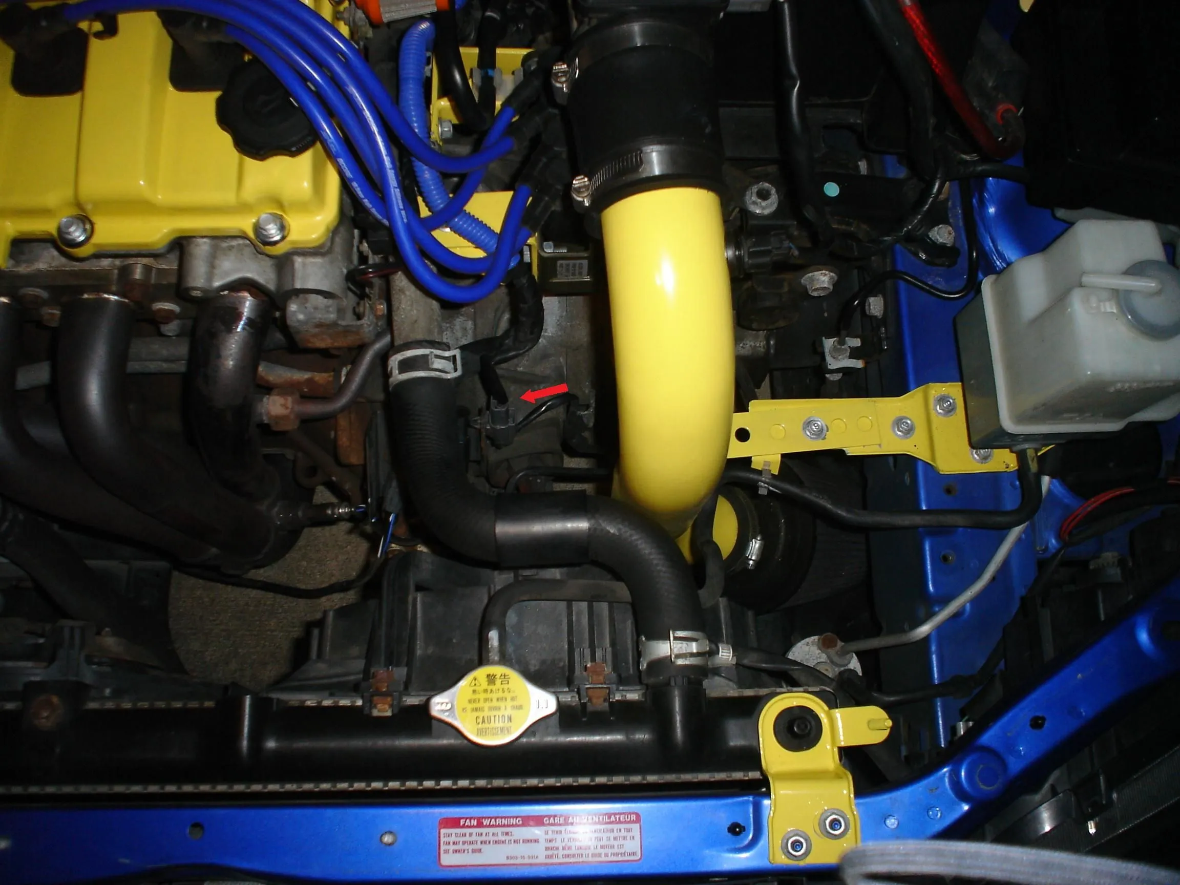

My reverse lights stay on 24/7 when the ignition is on. No matter what gear it is in. I have resulted to removing the bulbs. What sends the signal to them and is ther any way of testing it? I think it may be the sensor on the frount of the tranny but i am not sure. Any ideas? (help)

Anyway, I checked my Haynes manual, and although it's for the earlier gen proteges, I'm guessing it's the same. The sensor in the front that you see is the correct one. Have you tried disconnecting that sensor to see if the lights go off? There might be a short somewhere along those wires, or the relay could be shorted internally. Do you have a test light or multimeter? One wire should be powered anytime the key is on (forward, not necessarily running). When you put the car in reverse, it should activate that switch/relay in the tranny and send the signal to the lights. Anything in particular happen when you noticed the lights staying on?
nothing i started my car to warm up got out and was like wtf? I thought it was but i can not even find the part in an auto parts store. They have a "relay" and costs 50 bucks and a week to get in so i do not want to buy it till i can tell it is the problem. i am wondering what activates the switch. Relay sounds like it is part of the fuse pannel and that seems to check out.
Get yourself a test light (a few bucks at a parts store). Turn the key forward, but don't start. Put a bulb, or both, back in and disconnect that sensor on the front of the trans. The lights should turn off. Check all of the wiring to make sure there aren't any stripped spots in the insulation. One wire should light the test light with the key on, the other should not. If both wires light the test light, they're touching somewhere. If one lights and the other doesn't, the switch is shorted internally. Replace the switch on the trans.

Ok i could no wait till the weekend. it is the sensor on the frount of the tranny. There is a 2 plug conector going to it. i unpluged it lights out. Then i hooked up my multi meter and the one is hot when the ignition is "on" an the other is only hot (or supost to be when in reverse. So to answer your question find the hot one when it is turned on and tap into the other one and there will be your 12 volt for your camera. I jumped the two and lights. My sensor is stuck in the closed postion and do not know why but now i got to get a new onw. All the wires looked good going into it. So on the search now. But there is your answer and if you follow that wire back with your new wire and put it into the loom you will never be able to tell

Read what I wrote in the other posts about testing the wires on the sensor. The one that is not powered by the key (ignition) but is powered when your in reverse is the one you want. Splice into that and you're good to go.
