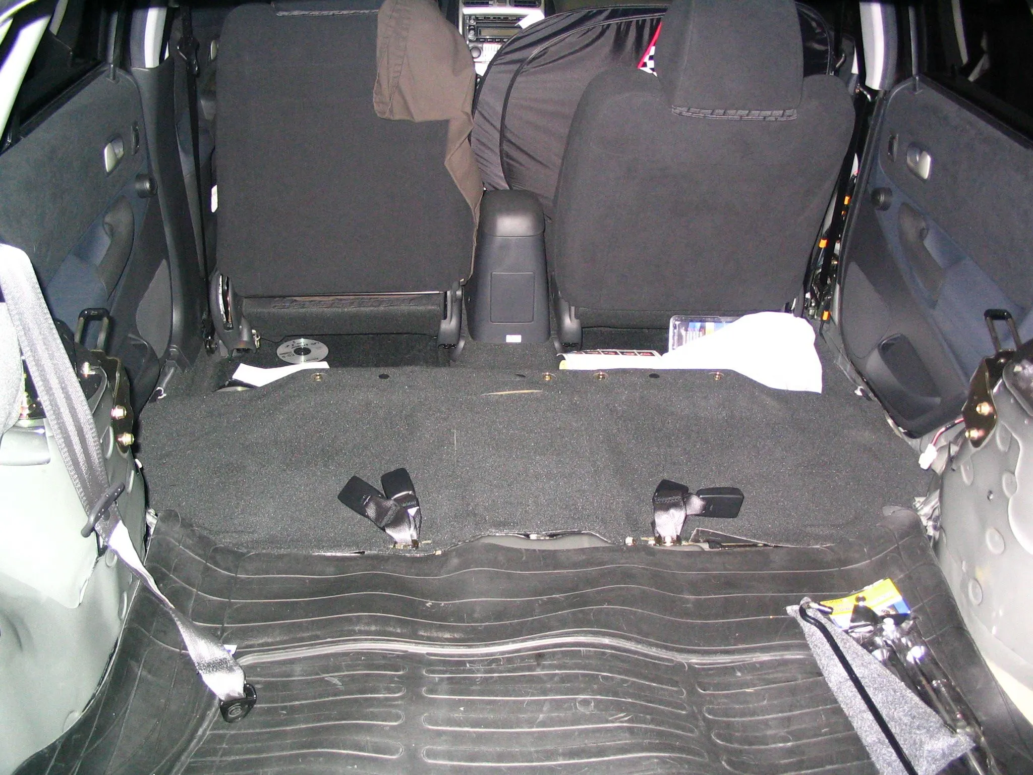

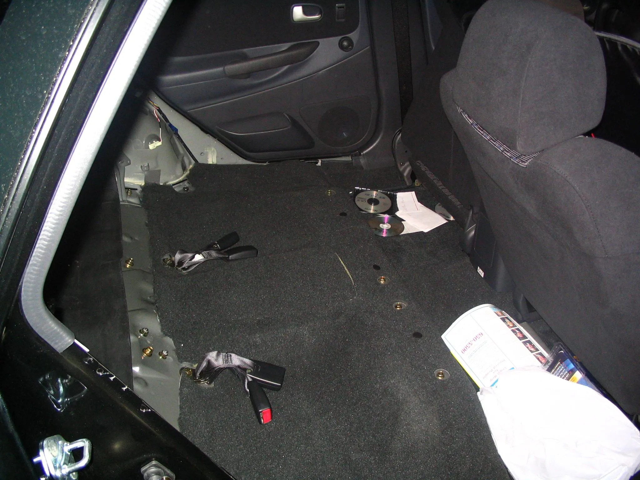

Since i was having trouble with the HU removal, I figured what the hell, I'll move on to running the wires for the amp. Need to remove some stuff to do that (and to install my Eibach springs when they get here), so check out the pics. Figured I mine as well do some weight reduction while Im at it. :) I cant wait to drive it like this and see how loud it is.

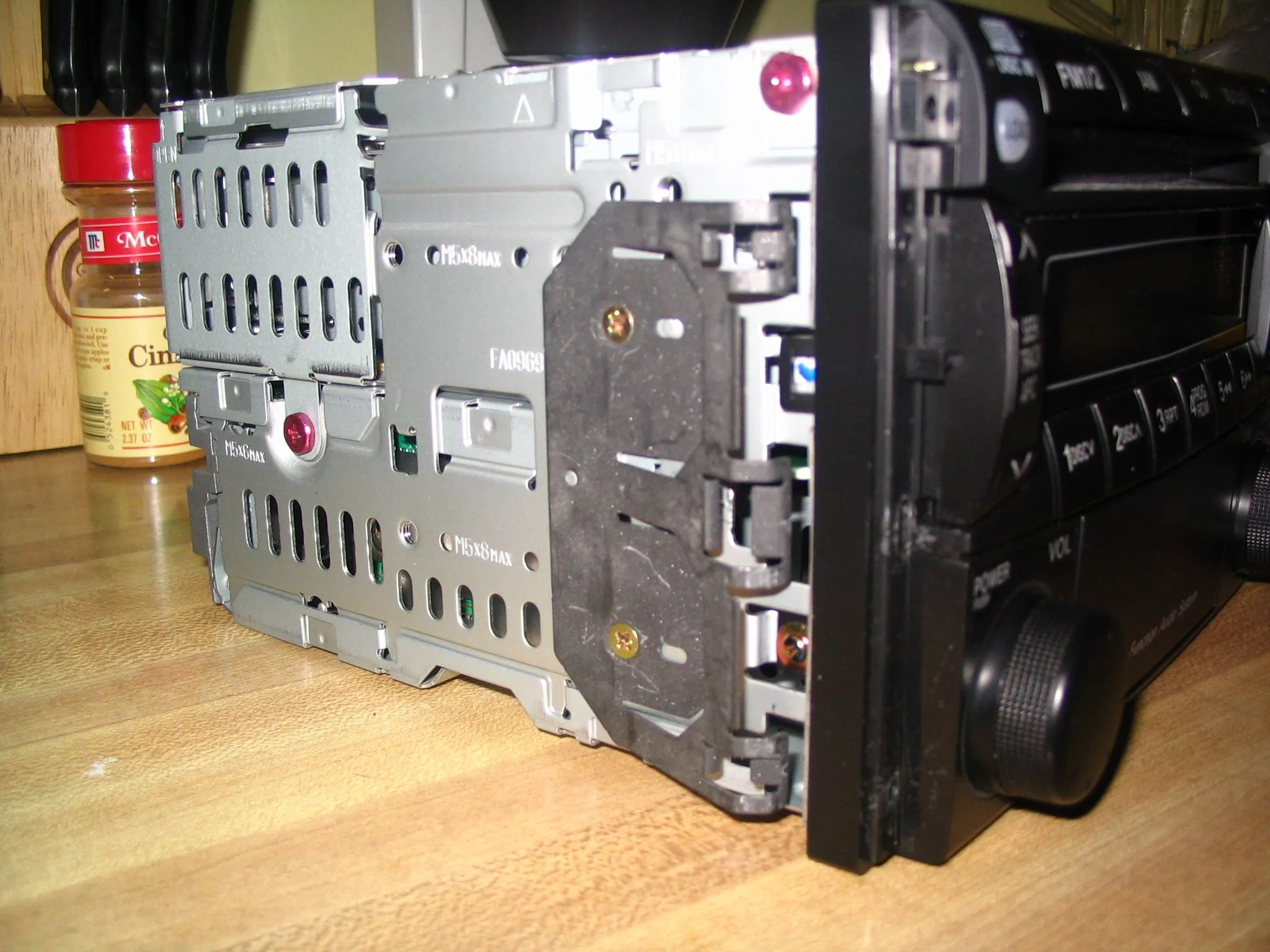

I finally got the head unit out, but I couldnt use this method, cause I couldnt get the cover off of the steering wheel. So instead, I just reached my hand into the dash near the radio, and pushed on the metal bracket that is holding the radio in, and pulled out on the radio at the same time. That got one side, then I removed the glove box, and did the other side. if youre having trouble picturing this, I attached a pic to show you the bracket we're talking about.
hope this helps everyone who hasnt done this yet. what a b**** this was, waaay harder than it should have been. Thats why I dont install stereos for a living.
