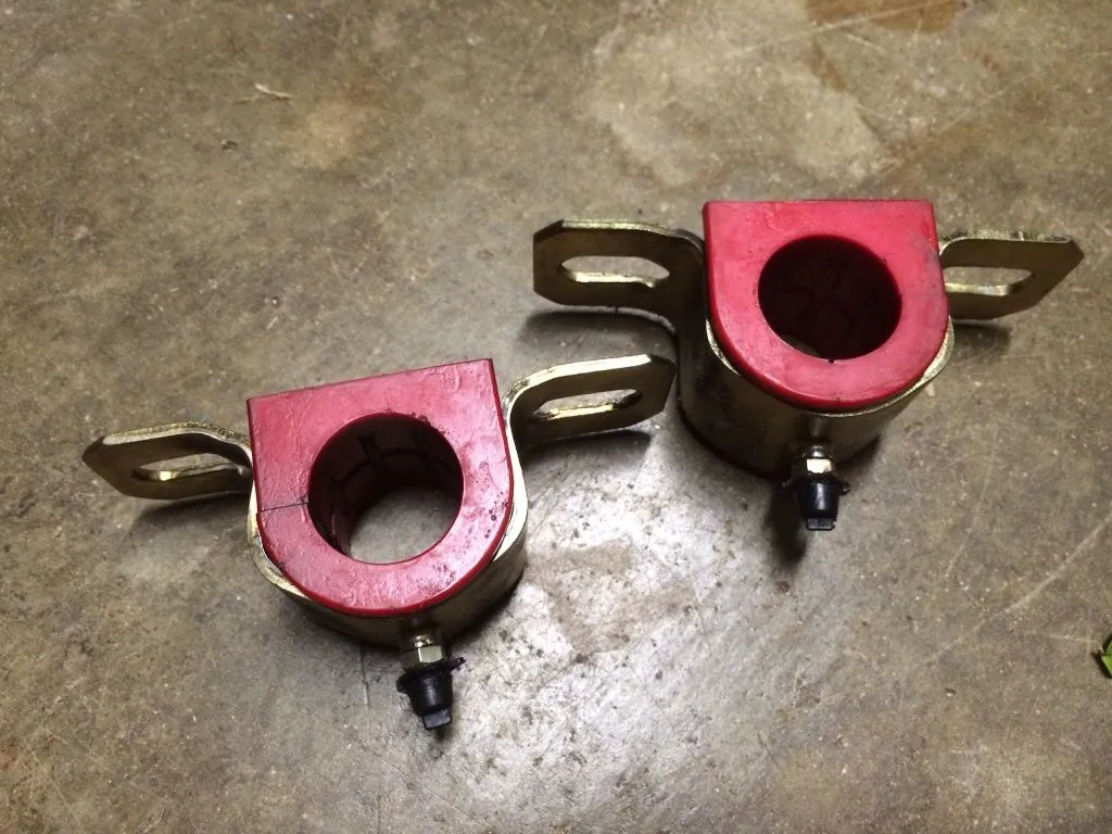

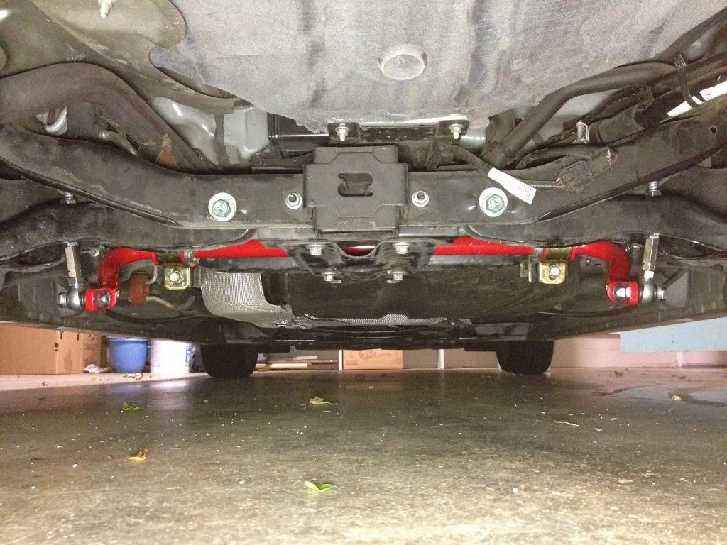

Installed a Racing Beat RSB, AWR endlinks and Energy Suspension greasable brackets. However, I keep breaking things... 1st it was the endlinks... I broke the factory ones (no surprise there) and I also broke 2 sets of CorkSport ones. Finally I changed to AWR endlinks and now I bent the brackets way out of shape. The tech at Energy Suspension thinks the angle is too steep and that I need to adjust the bar so it's more horizontal. They are sending me new brackets but suggest not using them with my current setup. What do you guys think?
Current setup...
It seems like they may have given you the wrong brackets for the bushings you are using. The brackets seem too big and allows the bushings(and ultimately the swaybar) to do quite a bit of walking under hard transitions.
Everything was good and tight for the initial install. The pics of the brackets are after ~6 months of use.
You need to contact JBR or Tripoint for a set of their brackets. They are MUCH beefier. The Mazdaspeed 3 brackets are a little beefier and may solve that issue also.
I like those new JBR brackets. But, brackets are not universal. His is specifically for 1.25 diameter bars. Racing Beat is using a 1.06 diameter bar. Cannot just swap. Would need to change out the whole bar. Unless... JBR is sourcing his bushing from Energy and just machining his own brackets. Would have to find out the height and width of the bushing.
Everything I've seen points to the brackets from JBR, Tripoint or Energy Suspension for the 5 or 3 are the same size. Only the ID of the bushing is different to fit the specific swaybar being used.
I had a Tri-point bar on mine and also bent up the original brackets until they sent me the redesigned set. They only lasted about two weeks for me though. That TP bar is STIFF.
why are you not using the racing beat bushings and brackets?
Damn good question! Can’t blame something that was not deigned for the intended purpose. It looks like the bar might simply be to stiff for that ES bracket to hold. The Tri-point brackets should work (it looks really HD) but you’d need to take measurement and source the bushing separately. Since the bar is the cause of the problem, you need to address that, not simply patching it.
Wanted something greasable. The one from RB is not.
Damn good question! Cant blame something that was not deigned for the intended purpose. It looks like the bar might simply be to stiff for that ES bracket to hold. The Tri-point brackets should work (it looks really HD) but
youd need to take measurement and source the bushing separately. Since the bar is the cause of the problem, you need to address that, not simply patching it.
Actually just got a response from JBR and the energy suspension bushing that I currently have will work with his new billet bushings.
