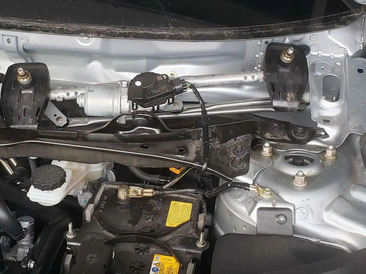

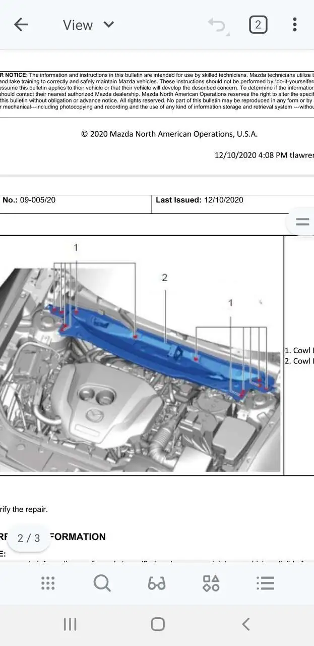

So this may have been discussed on this forum before but I finally took a close look at this tsb related to the rattling clunking popping noise. It appears that it's the cowl bolts. Which basically looks to me like strut tower cross brace bolts, but they are calling them cowl bolts. Strut tower cross braces typically increase torsional rigidity. Kinda important. Most information I'm finding on forums and Facebook is it's just two bolts on each side, total of four bolts. But if you look at the TSB its actually a total of 12 bolts that need to be tightened. The reason the other eight bolts are not discovered is because it's under a plastic cover. I'm going to look at mine this week and check the torque

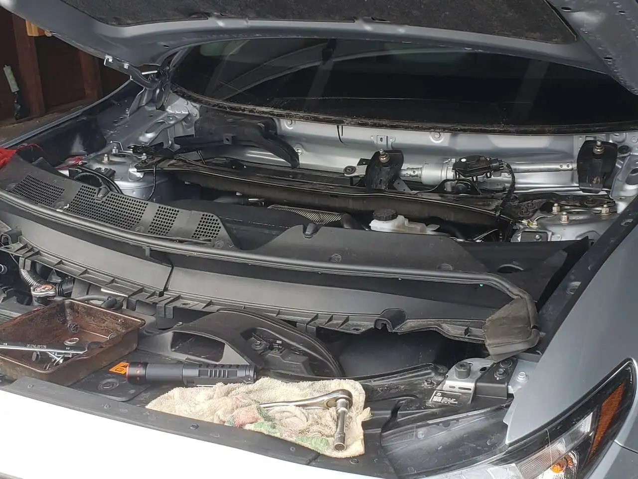

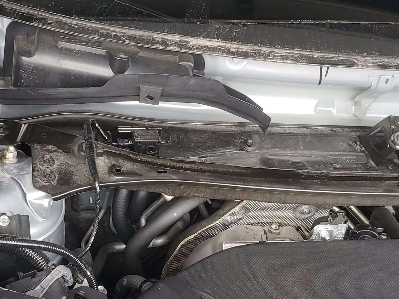

Okay there are 12 bolts. Took me about an hour going slow to get to them First you have to pull both wiper arms then you have to pull the little tiny trim pieces on the lower right hand and left hand corners of the windshield then you have to pull the windshield washer hose Union under the right hand Hood hinge then you have to pull five plastic push pins and then the whole plastic assembly comes off. To get the 12th bolt under the windshield wiper motor assembly you have to pull two 10 mm headed bolts that hold that assembly down and just twist it a little bit to get that 12th bolt. All mine were loose. You could just pop the plastic push pins and get to the 2 additional bolts on the strut tower on each side without going through all this. It's not that big of a deal but if you don't want to you can always torque the four strut Tower bolts which probably are doing most of the work. I could have had this done under warranty with the TSB as my reason but it was a lot quicker for me to do it myself and now I know it's done right.

Wow, perfect! Hopefully this solves the clunk.

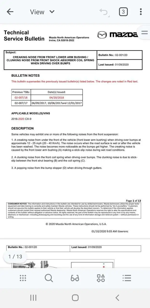

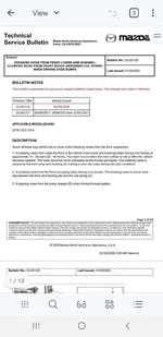

Be interesting to see what they say. Here is another TSB that is relevant.
