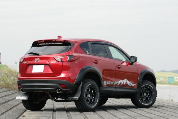

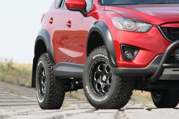

This would probably look tight lifted
This is exactly the thread I've been looking for, too bad it died 2 months ago. Since I've dropped all my previous cars, I think the above CX-5 might look better with some coil spacers. The Subie Forester has a 1" kit so I am hoping someone makes it for our ride, and best part is it does not change the suspension ride quality, which is already stiffer than 8 other compact SUVs I tried before buying. The roof top light kit above looks pretty good too.

For some reason, I could see Mike M. using that to get to his mountain destinations.
I'm not goanna lie I actually like that; it's pretty unique compared the usual lifted vehicles you see. Definitely would add a stiffer rear and front sway bar to that (there are a few avail).
That's probably a diesel too. Imagine tuning it to roll coal.. I'd like to see the look on a ford or dodge diesel truck driver when they get rolled by a Japanese cuv lol!
