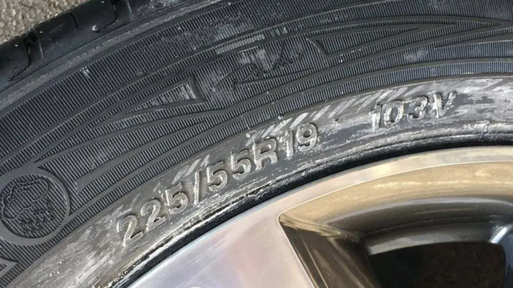

Yes, no complaints on the cost. With installation、disposal fee、sales tax、and DT 10% promotion, my actual total cost is $427.95 for a set of pretty decent new tires.
Are yours speed rated?
225/55R19 103V, 103 XL Extra Load and V speed rated.

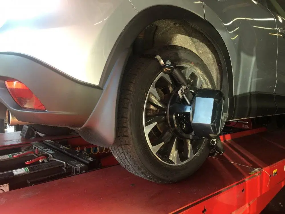

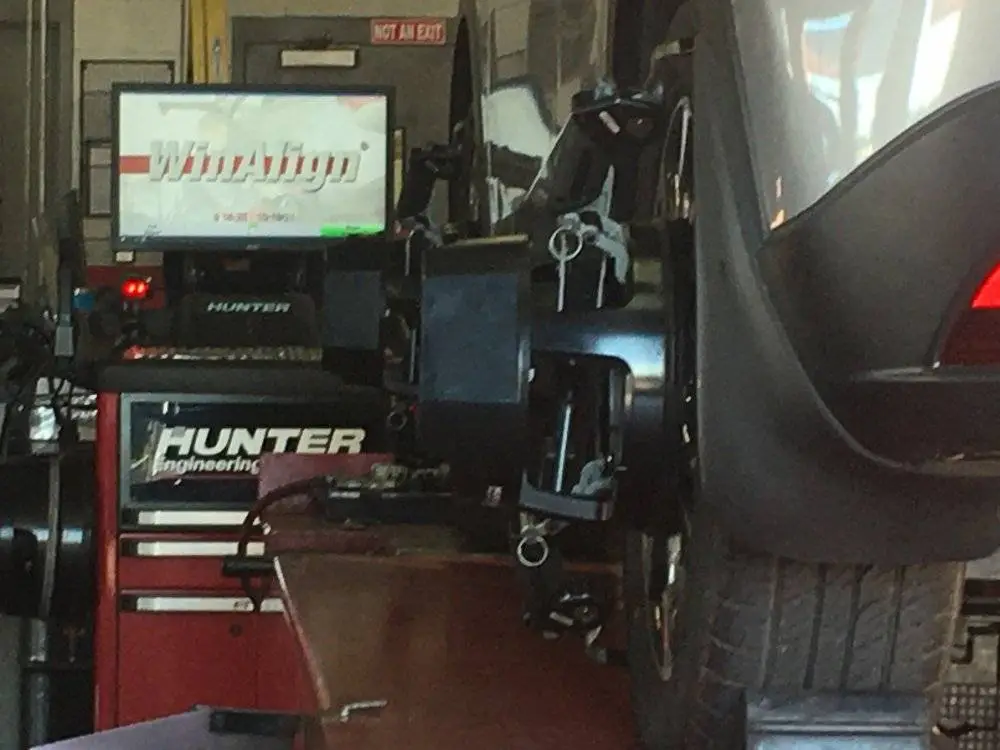

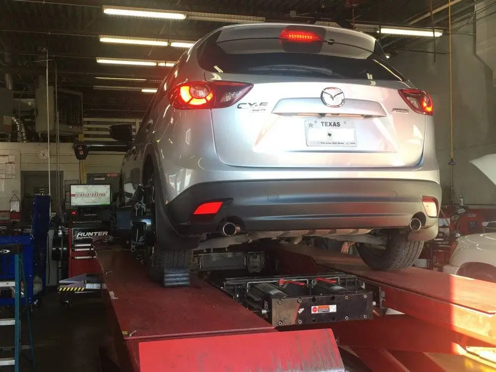

Did the 4 wheel alignment 3 weeks ago on my 2016 CX-5 GT AWD with new Radar Dimax AS-8 225/55R19 103V tires even though I knew the alignment should be fine based on the tire wear on my stock Toyo A23's. I had an excellent experience with the Brakes Plus near by when I did the 4 wheel alignment about 3 years ago on my 1998 Honda CR-V the first time at 183K miles. The young tech was really good, and I had no complaints after the alignment.

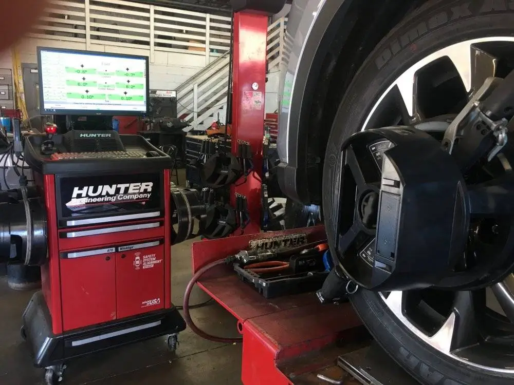

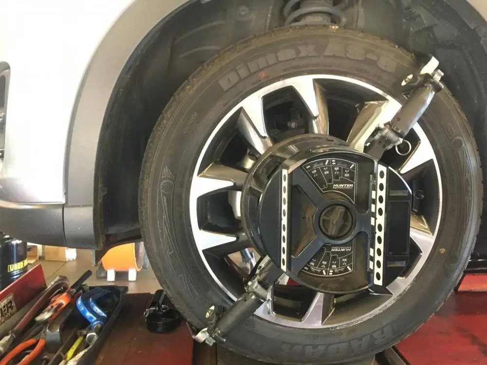

Unfortunately that young tech went back to California where he is coming from, and a different tech was working on my CX-5. The store has upgraded to a newer Hunter HawkEye Elite® Alignment Machine this time and the obvious thing to me is the tire hook-up sensors used to be clipped on the wheel edge, now they're attached to the tires directly. This definitely prevents any possible scratches to the edge of expensive alloy wheels.
The whole alignment process is fast as advertised by Hunter website. It took only about 20 minutes and it's done. But I went back after I test-drove my CX-5 and asked for re-adjustment the toe-in as I felt the steering wheel is off-center to the left more than before. And this time the store manager did the alignment and the result is satisfactory.

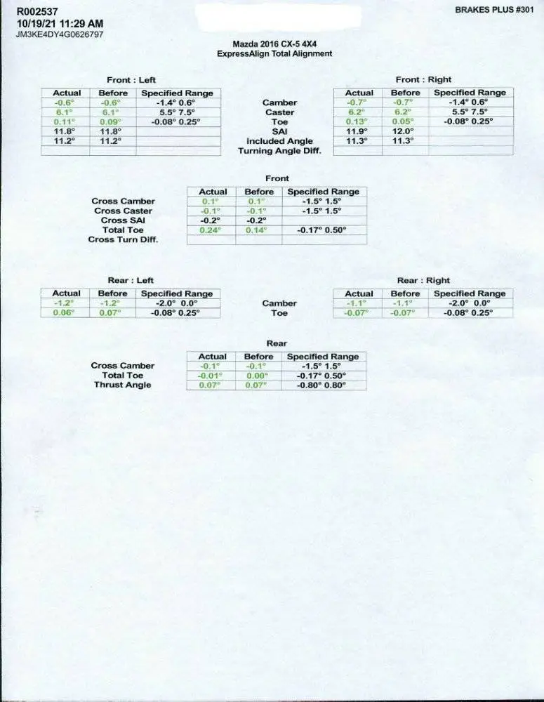

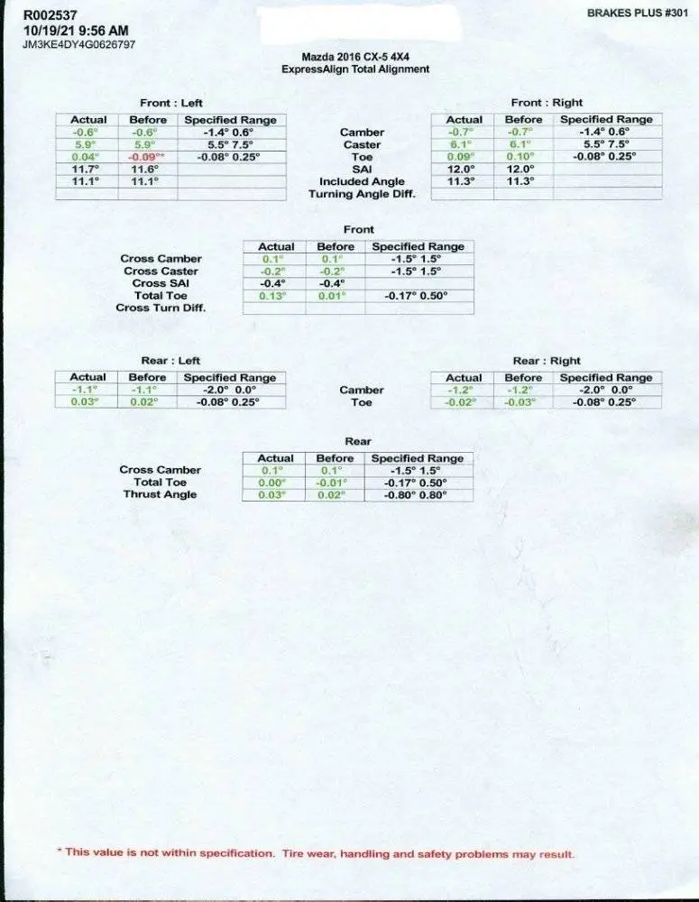

Although I usually want to watch the alignment closely just in case, but this time I chose to let the tech at the Brakes Plus do his job without asking anything. The tech initially said the left-front toe-in is off a bit, which requires some adjustment and the free alignment check is gone. He said he's going to put more toe-in at left-front in to meet the spec where the Hunter machine showed a bit toe-out. As I mentioned in previous post, after the alignment I really hated the off-center feeling on the steering wheel especially it's more to the left. I also noticed from the print-out that the CX-5 actually missed merely 0.01° toe-out at the left-front which will be within the spec if the tech positioned the steering wheel a bit to the right before the alignment as the total toe is within the spec. I felt my money is wasted for something which is actually getting worse on steering wheel centering, I decided to take my CX-5 back after I test-drove the car. The store manager was nice and put my CX-5 on the machine again. He agreed the tech should adjust the right-front having it more toe-in at the first time with the steering wheel centered properly, so that my steering wheel will be more towards right while driving straight. And he did it based on my suggestion adjusting the toe to the right-front. And the result is good on steering wheel centering position but I "donated" $64 to my local Brakes Plus store as my CX-5 definitely didn't need any adjustments on alignment at beginning!
I understand the alignment is sensitive as we can see the "Actual" data on the first print-out and the "Before" data on the second print-out are not the same although they're supposed to. Each time the car been put on the machine the readout can be different than the previous time. Luckily the camber and caster at front and the camber at rear are all within specs as these can't be adjusted.
