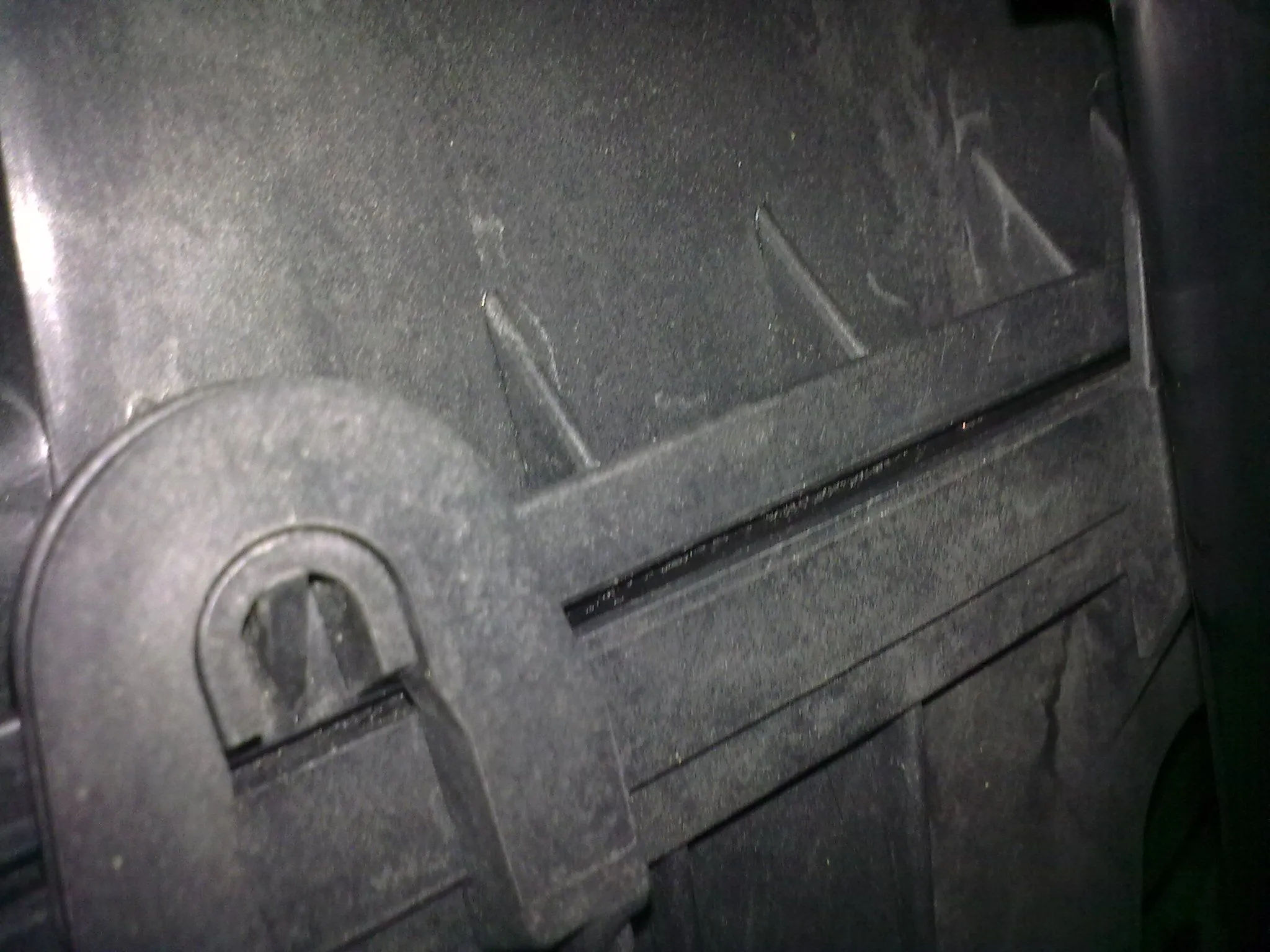

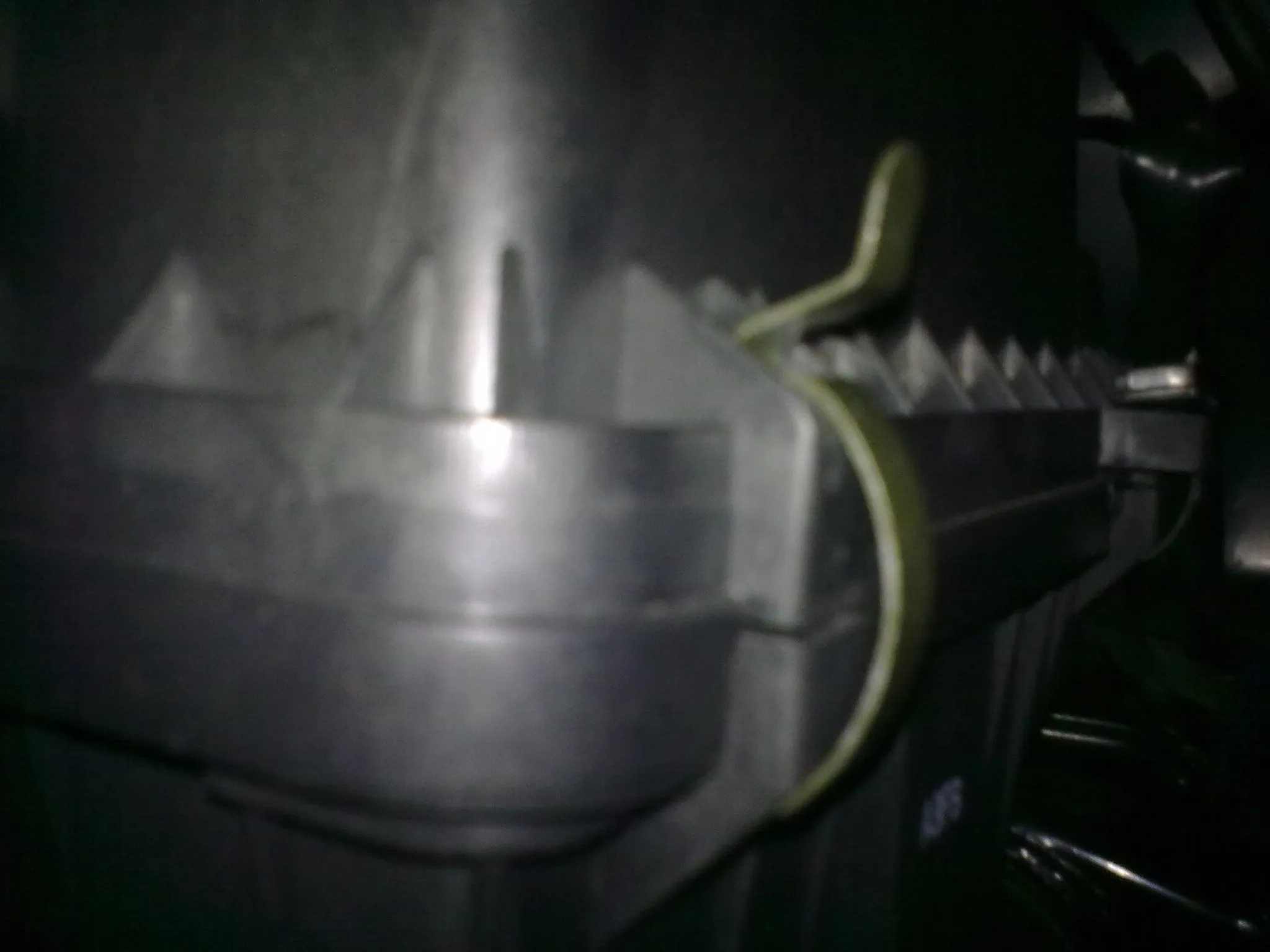

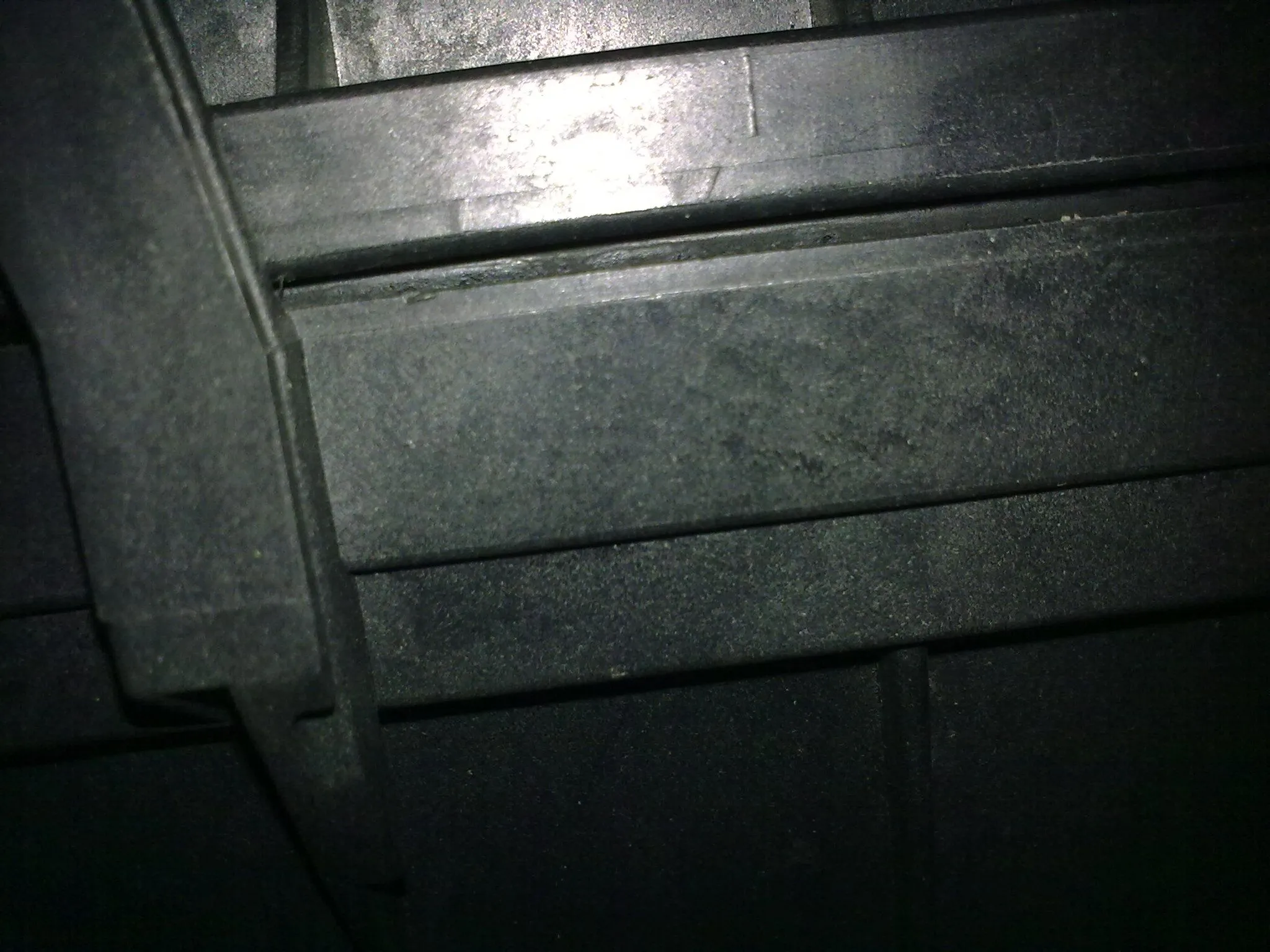

Hi guys, here are some pic of the intake box. These are cell phone pics so hope you guys can see what I am talking about.

That looks fine to me. Unless you trim the K+N rubber(I wouldn't) you probably won't get a better seal.
