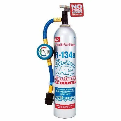

Refilled and now much better
Thought I'd update you guys and maybe help anyone else with the same issue.
I searched for a long time to see if there was anyone else with any simmilar problems but really couldn't find any good information.
So after doing a lot of research i decided to try and refill the ac system with R-134a with subzero synthetic A/C booster from autozone.
http://www.autozone.com/autozone/ac...&fromString=search&itemIdentifier=532242_0_0_
It came with a gauge and a hose to hook it up to the Low Pressure valve for the ac system. I hooked it up and according to the gauge it was low. I followed the directions and turned my car on with the ac on full and ended up putting most of the can into the system before it came up to the correct PSI.
It made a world of a difference. Even when its 98F outside the ac cools the interior off to 70F in about 5 min. I'm very happy with this fix and it only cost me 30$.
If anyone has any questions feel free to ask.
