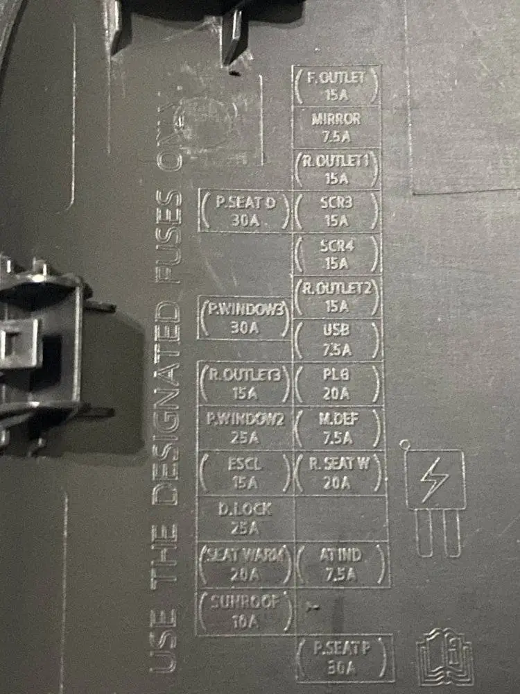

I've wired my dashcam to the fuse box in both my Mazda 3 and now CX-5 and it's been safe and had no issues. I've never had a fuse blew or any electrical problems. In the photo you would want to connect to the "F. Outlet 15A" which is an accessory outlet. In short, if you turn on your vehicle and start, the dash cam will power on and start recording. If you turn off your vehicle, the dash cam will shut off.
