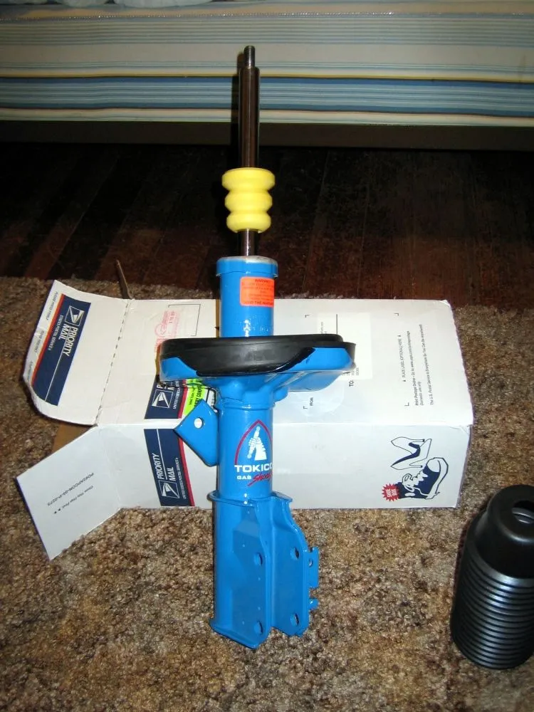

Pics, anyone?
And just because I'm a cool guy, here is a pic with a Tokico strut with the MSP bumpstop on it and some spring seats. Brand new Mazda dust boot is also shown.
All the rubber crap cost me nearly $200 brand new, which is what you should get too. Peace and be safe when doing the swap.
