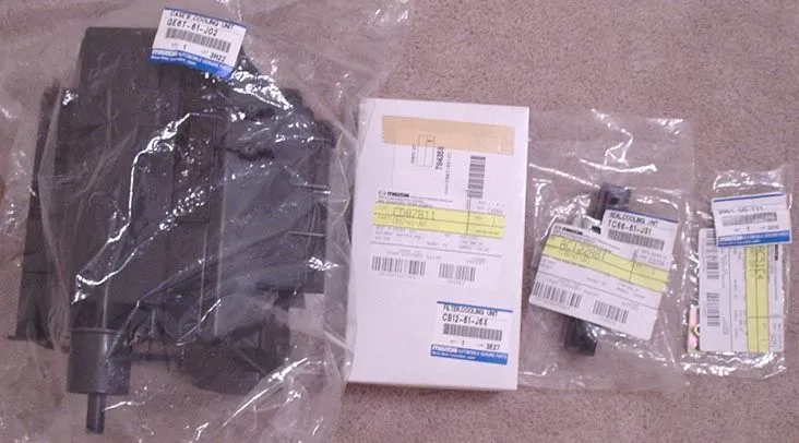

The few parts you need are:
GE6T-61-J02 AC evaporator lower half case
TC86-61-J31 AC evaporator case filter plug
CB12-61-J6X aldehyde filter
J001-50-171 license plate holder bracket (believe it or not, this part works perfectly with this setup.. more later)
metric size license plate bolt that fits the bracket
2 suitable size self tapping screws
set of finisher washers
all of those parts EXCEPT for the aldehyde filter can be purchased at any local Mazda dealer.. the filter you *must* import from Europe... however, if you are just content with a normal pollen filter, you can order GE6T-61-J6X locally and it's half the price of the aldehyde filter.... funny enough, the lower half case is not used on ANY car sold in the US... it just happens so mazda mistakenly put it in their US parts database to let everyone use it to their advantage :D

and if any of you ever ended up getting this and want to get replacement filters:
GE7B-61-J6XA non-AC pollen filter
CB11-61-J6X non-AC aldehyde filter
The only way you can get these 2 stupid parts are importing

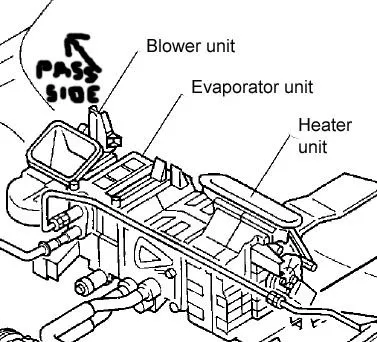

the filter is installed in the evaporator or air duct box.. and here is where it is in the car:

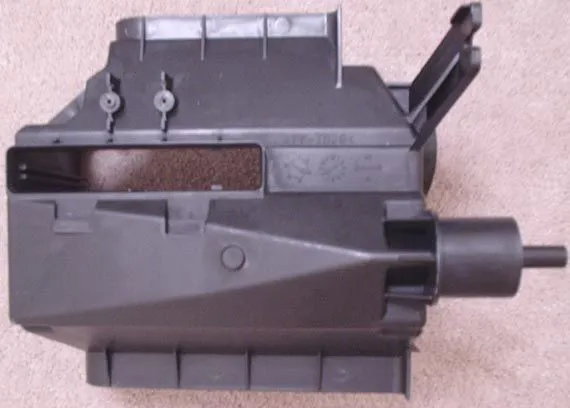

you *have* to replace the bottom half of the evaporator box so that you have this access hole to install the filter:

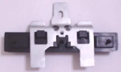

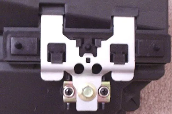

notice in the other pic where the bottom of the box is shown, there are 2 screw holes and no bracket... well the bracket is not available as a separate part and the only way to get it is to order the WHOLE evaporator unit with the filter... with some creative parts bin searching, the license plate holder bracket from the MP3 front bumper fits perfectly after some creative use of washers:
a close up of the bracket piece itself, no modifying needed!

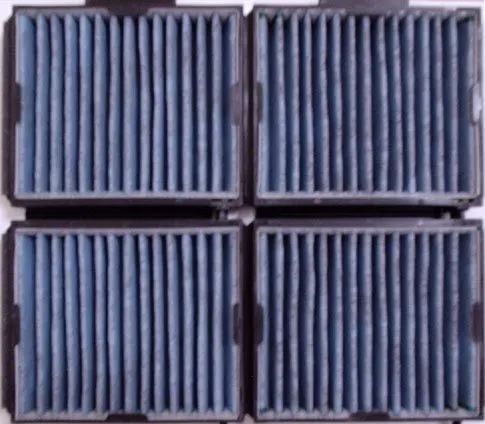

this is the white side of the filter... this is the pollen filter side... it's supposed to face the blower

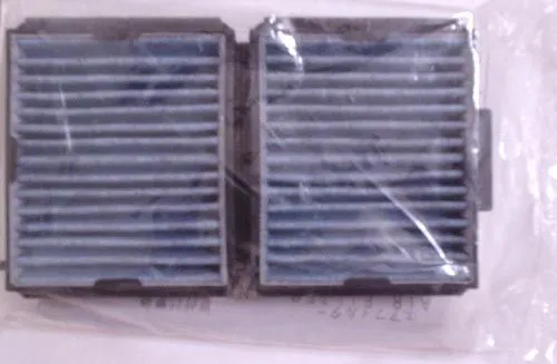

and the blue side... this is the aldehyde side... this is where all the nasty smelling s*** gets filtered out (no more worries driving behind some asshole spewing black smoke everywhere!)

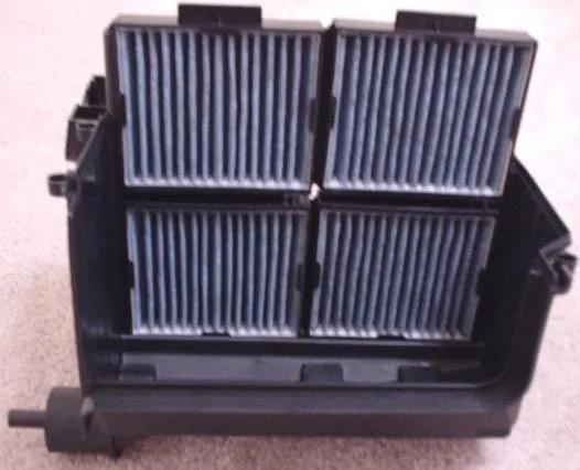

the 2 piece filters slides into place and tada!

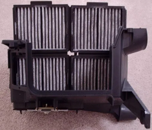

this is the blower side of the box:
and finally the other side of the box facing where the evaporator is supposed to be... it then will connect up with the heater core unit...
so there's a little hole between the filters.. big deal... it'll have 99% efficiency anyway

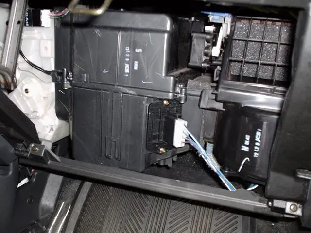

so after I recovered the freon and disconnected the lines, I removed the glove box:

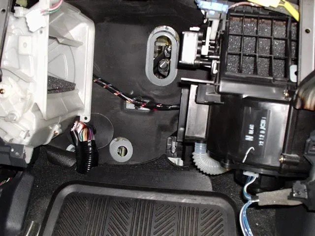

and having all of those electrical connections to the sensors and fan resistor out of the way.... 2 bolts and the whole unit comes out...

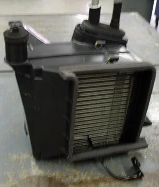

this is where your cold air comes from people!

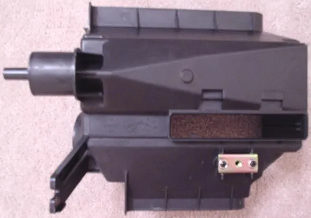

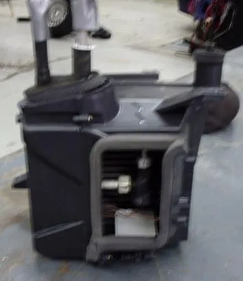

and the blower side where the TXV is

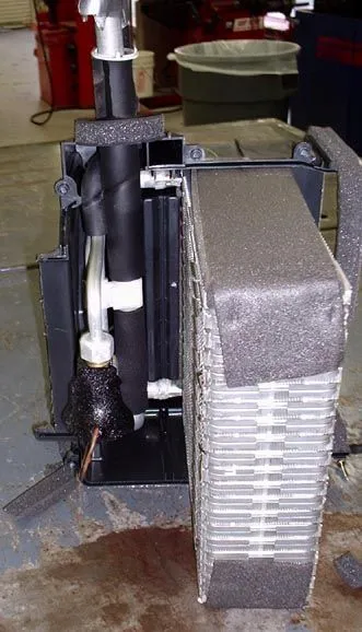

and now what is mysteriously inside that black box
