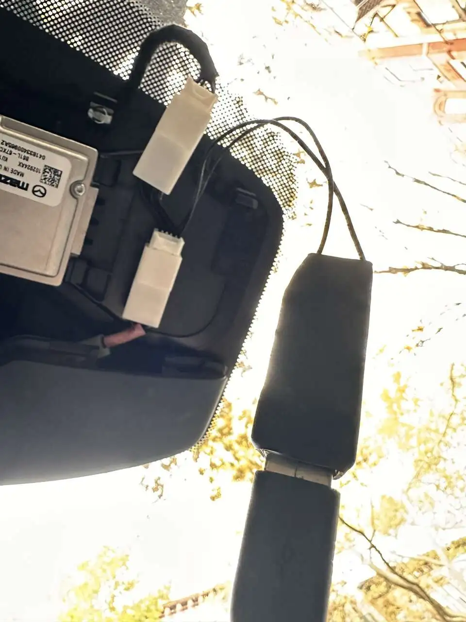

Hi anyone have issues with their Dongar adapter USB not giving power?
I have a 2019 cx5 grand touring.
I purchased the Dongar Adapter type D and was able to install it properly. It clicked, fits and shows my auto-dim rear view mirror with power (green light is on).
However, when I plug the usb wire from my dashcam to the Usb on the adapter, it doesn’t turn on. I return the wire to the cigarette power below to make sure wire works and it does.
I thought it maybe the wire is finicky so I tried diff wires, didn’t work.
Thought maybe it’s the dashcam, so I used another cam - didn’t work either.
Now I thought maybe I received a one in a million defective Dongar adapter, so I replaced with Amazon and same result with the new adapter.
I’m scratching my head as to why something so simple is not working.
