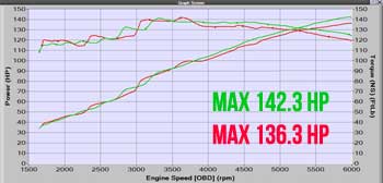

CorkSport, I recently ordered your new 2014 Mazda3s (2.5L) intake. I'm curious to know what the gains are. The dyno graph that's on your site for that intake appears to be for a 2.0L engine based on the power outputs.
That dyno is on a 2.5 automatic. The point you want to compare is the gains from the intake. The dyno dynamics dynos show lower #s that your run of the mill dynojet which is why the numbers look lower.
