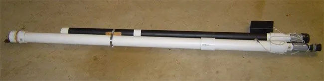

Just use a sprinkler solenoid valve its like $15 at Lowe's. It needs 24volts to operate so connect 3 9V batteries to it with a switch, I recommand having a throw switch and then a push button to fire for safety purposes. I've got a 2.5 inch barrel and a 2 inch air chamber. I usually get about 2 shots before I have to refill the chamber. And I've broken 2x4s with my gun from 20 feet away.
Iamgoodyy said:
You can't use a bike pump to compress the air because you won't get enough PSI into the chamber. You need 75-100PSI to do anything worthwhile.
Nice kit...btw, some bike pumps go that high...mine does..
