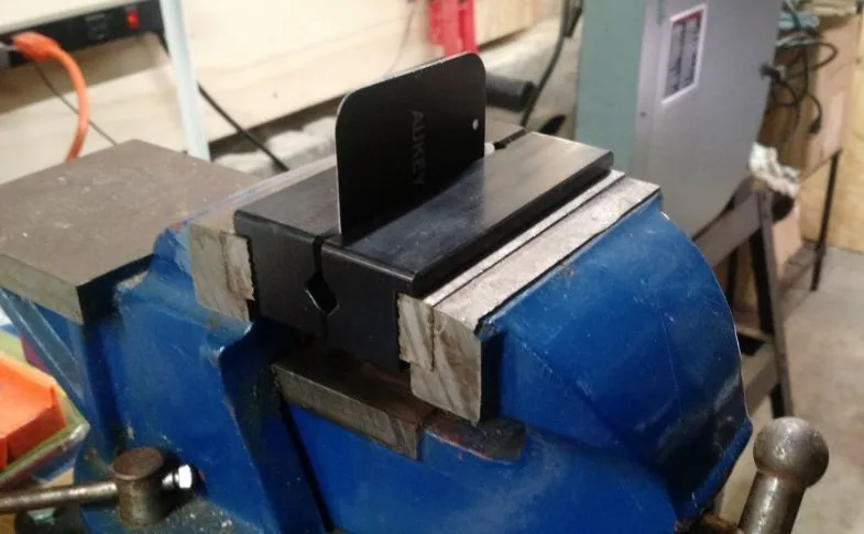

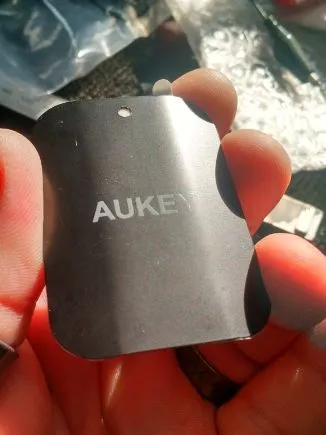

These bends allow this thin metal sheet (included with the aukey kit) to form to the back of my phone (inside the case) for the magnet to catch. Thin and light, its barely noticeable thru the soft Fosmon case on my phone. Theres also a smaller round option in the kit as well, that (in retrospect) would have worked just as well.

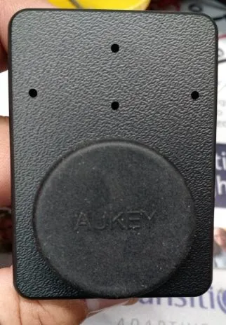

Marked where I wanted to Aukey mag-pad to mount on the proclip. I didn't want the pad to high as my phone has the camera lens high on the back, so the metal plate (above) would be on the bottom 2/3rd of the case. So I put the pad low, allowing the phone to sit "centered" on the proclip.
attachment.php

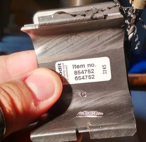

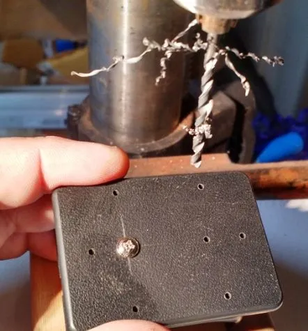

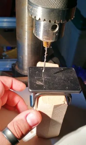

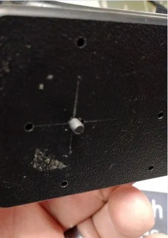

I pulled the silicon vent clip fingers off the back of the proclip and removed the screw to use it to size my drill hole.
attachment.php
** NOTE : I scraped off the raised "proclip" logo sticker as not only would it interfere with the pad mount location, I also didn't want to see it! so I just stuck it on the back side where it wouldn't be seen. The trash would probably have been better!

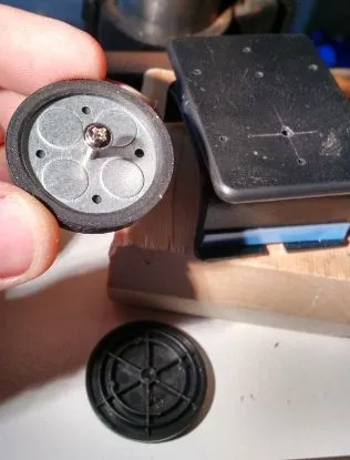

this is the magnetic disc with threaded center. It sits in a rubber pad with a channel cut for it to grip. Very nicely made, and perfect for this mod. I removed the plastic back (bottom of the pic) as its unneeded. The rubber lip will sit (and compress) flush against the proclip base.

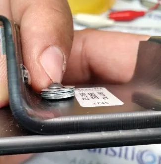

I found a longer screw that threaded into the magnetic disc (metric) and used washers to space it back so just what I needed to catch and draw thru was sticking out.

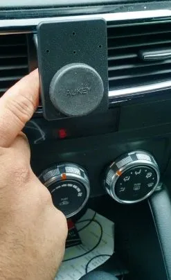

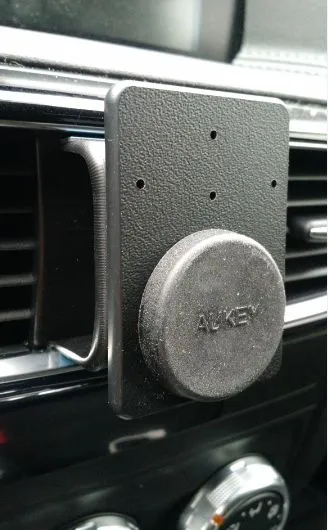

I mounted the PRO CLIP in the center of my vent trim, as I wanted the vents free from obstruction. The proclip works perfectly fine as is, no modification. I did not even remove the backing on the sticky tape located just under the tabs that click into the vent trim. No need. Its very secure and clever mount. Totally worth the money.
attachment.php
POST #3.... (why the F*#K wont this forum allow you to attach more than 5 files??)
The pro clip does NOT interfere with the operation of the hazards. Just stick your finger back and push on/off as normal. I use the VENT way WAY more than I use the hazard lights!
attachment.php

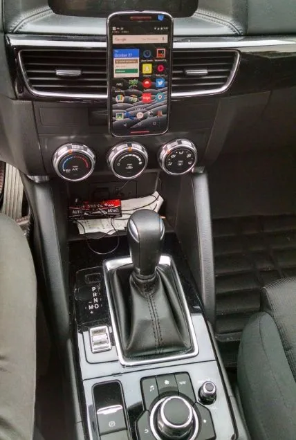

Finish product!
For me, Its perfectly aligned as to not block or hinder: infotainment, access to cubby, ac/heat vent, air, controls, hazard button, shifter.
I get in the car, and just slap the phone up against it, either portrait or landscape, and it sticks ROCK SOLID. Grab and go when you get out. I use the 12v socket in the arm rest with an aukey 2 amp charger (as the car only provides .5 amp from the console USB) and the wire runs right up the side of the center console and into the phone.
PLUS... I think it looks slick as H3LL!!!

Why the extra plate? Why not just attach the magnet mount right to the part of the pro clip that hooks into the dash part
There is no "extra" plate. The back "c" clamp is welded to the front "flat" plate. Its all a single piece now. See pic below; Everything on the wood block is a single piece.
I believe this is a manufacturing technique that allows them to mold the "C" clamp however best fits the car (both shape and thickness), without having to worry if theres enough flat and properly angled mount area. It also standardizes the interface between the phone attachment (in my case the magnet pad) and the clip.
