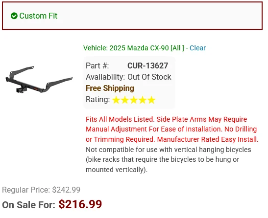

I ordered from Overstock accessories.
Hitch receiver
