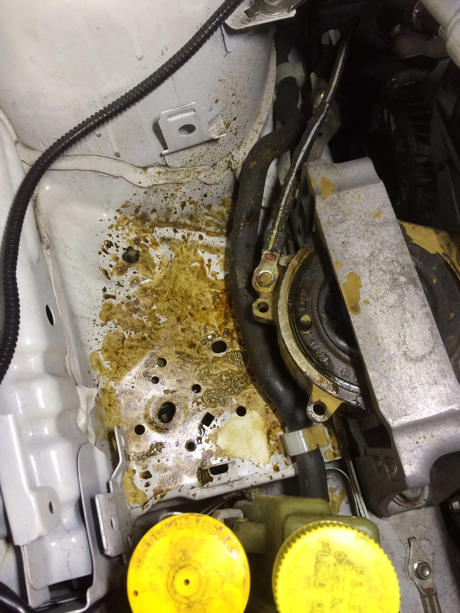

Passenger side motor mount exploded!
FukuokaKid
2024 CX-5 Turbo Premium
Looking for suggestions... Replace with stock or JBR 70 Duro? Anyone installed a JBR? How much NVH did it add?
Yeah, they do that, though that's one of the more gruesome ones I've seen.
If you replace with stock, it will happen again eventually.
Sorry, I have no input on the JBR. Actually I would like to know the same thing. (NVH) I want/need stiffer mounts, but don't want significantly more NVH as I'm trying really hard to keep this as sane a DD as possible.
i went with an AWR passenger mount, technically only made for the mazda 3. after about 2 weeks of having it in the bushing failed on it. AWR sent me a higher duro bushing for free which has held up pretty well since early this year. There is definitely more noise but the stiffness is soo much nicer. Now i think my trans mount is done but that's a whole other story.
**Update**
Thanks for the input! A call to the dealership got covered it under the powertrain warranty.
