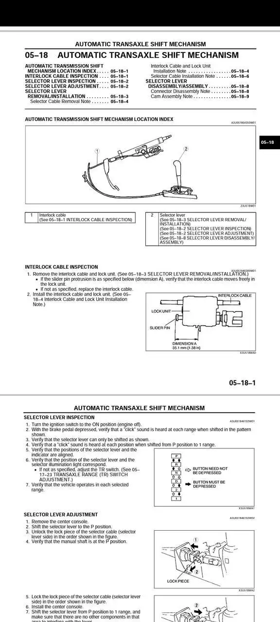

There's a few things you need to look into.
The transmission has both a mechanical adjustment of the cable, and an electrical adjustment of the selector switch.
Here's a link to the service manual for full instructions.

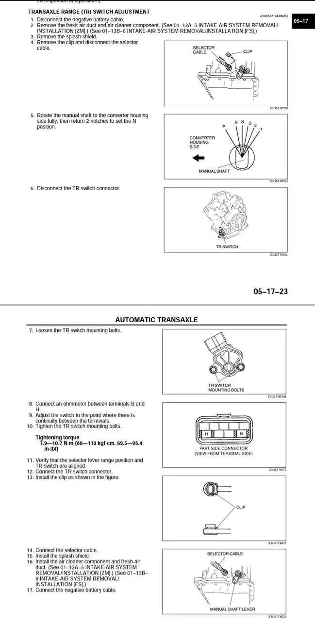

My car is a manual transmission and I don't know much about the automatic, but from reading through the service manual a bit, it sounds like you need to adjust your TR Switch?
Do this first, then check your TR Switch if it doesn't work.

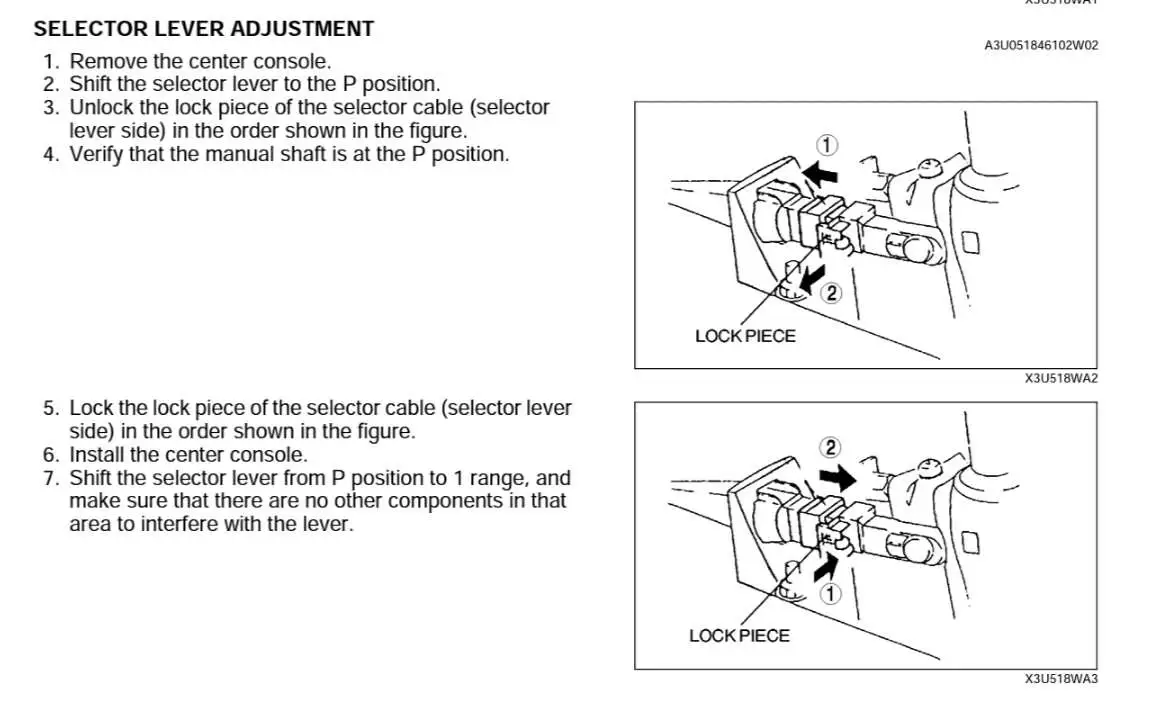

I'm thinking that your selector cable stretched so the lights aren't in sync anymore.
I figure checking the adjustment should fix it.
SOLVED. Adjusted the shifter cable about 3-4 threads.
