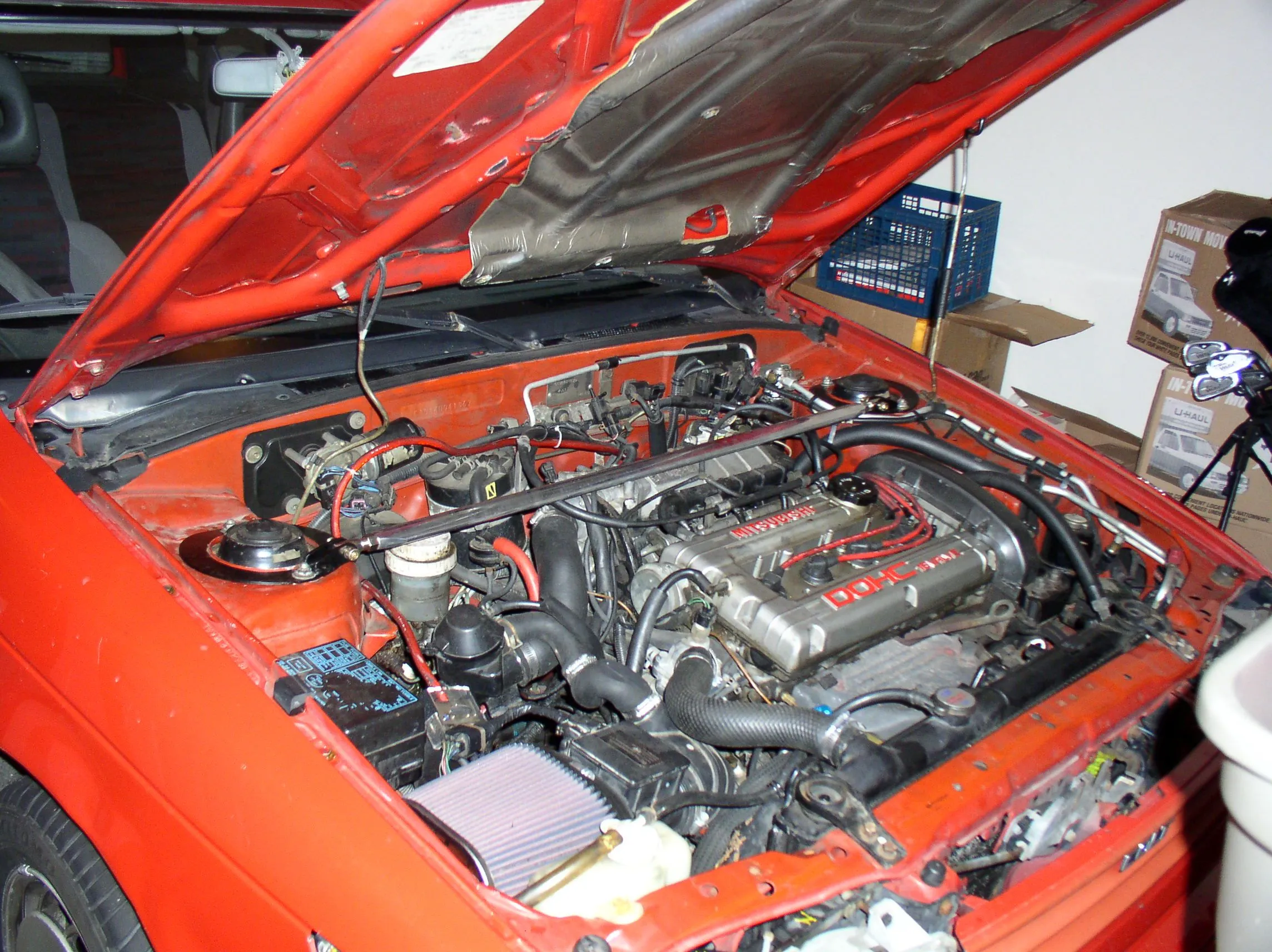

ok guys i have a few questions for you. has anyone tried an SAFC,upgraded injectors,hard IC pipes,FMIC,higher boost. from my understanding on this car the compression Ratio is 9.1:1 or something in that range.
i am looking at help a friend with his car. his car ran a 9.9 at the track.i think the car has alot more in it than that.
i currently drive a 89 Dodge Colt GT 1.6L turbo. the car has seen 8.9's at the track.and yes the car came stock with a turbo.
any help from anyone would be great.
