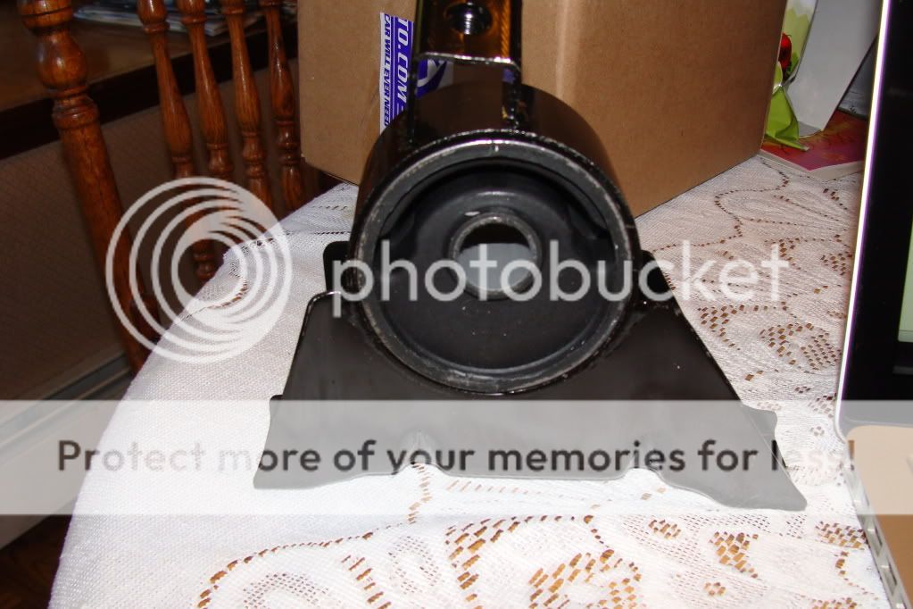

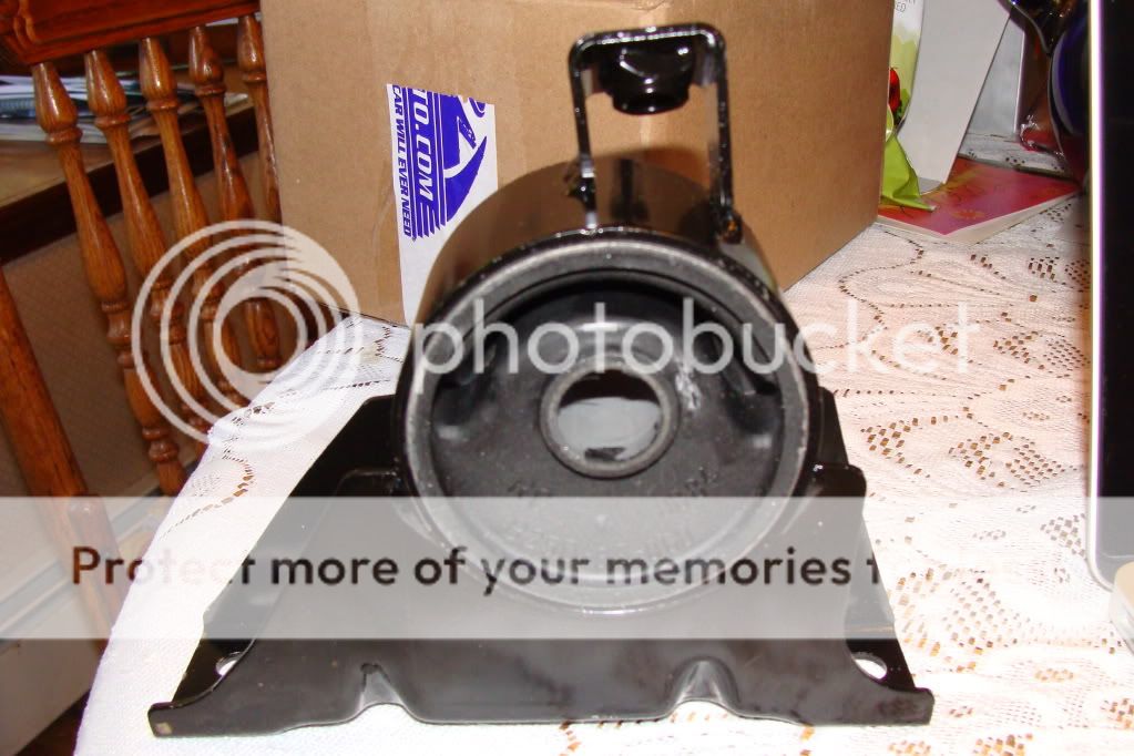

Hey, I just got mine (Beck/Arnley part) from rockauto on thursday, it looks OEM-style to me.
Have a look:
EDIT: You could always see if anyone might want to trade your new motor mount for a used OEM-style one in the FS section.
okay dude thanks a lot for those pictures!
so as it stands i can either keep the other three mounts that work and figure I paid $120 for a front, rear, and transmission mount then buy the one you got from rock auto.

I ordered the one from rock auto just as you guys above but the one i got is nto the same exact size as the stock on my p5. take a look at the little arm coming out of the rubber...its abuot 1/2" longer on the replacement and about 1/2" higher too:
Did I order the wrong one??

I noticed the same thing, it was a bit more of a pain to install but it fits (you might have to play around with a pry bar to get it all aligned).
The height difference is negligible, it's the fact that the Beck/Arnley part sticks out a bit more that makes the install a little more awkward. I've been using mine for about a month and it feels great, I suppose that's what you get with such an inexpensive part. Perhaps you should contact Beck/Arnley with a link to that picture so that they are aware of the fitment issue.
EDIT: Would you mind measuring from the bolt holes (chassis-side) to the flange (engine-side) on both of them? I'm kinda curious what the actual difference is, comparing them visually is a bit deceiving.
Yes, will post up those measurements...I guess its time for the dremmel.....
Dremel? That won't help at all, the problem in my case was that the flange that mounts to the engine was a little too long. It still fit but the engine-side flange was a bit crooked so I made it sit relatively straight using a pry bar. If you do that you'll be fine, no dremelling required :)
I realize what I wrote above doesn't make too much sense when you read it, but trust me, when you install the mount you'll understand what I'm trying to say...
