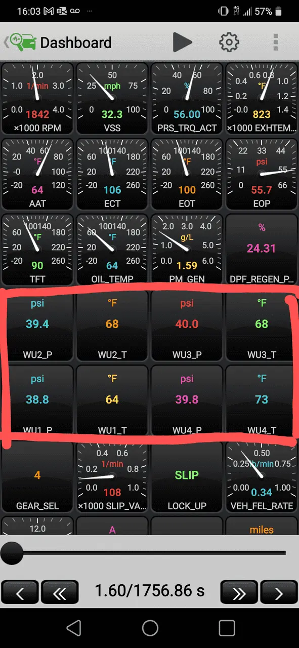

@RL911 yeah, it'd be nice if tire pressure was displayed on the info-tainment display on the newer systems. The data is there and accurate too. Also senses temperature as well. It can be displayed in real time with an app such as FORScan. Incidentally, the newer system with the transmitters in the wheel also take 1/4mi or so of driving to update the current pressure. When you first fire the car up, it's reporting the psi/temp from when it was shut off until you drive it some.
