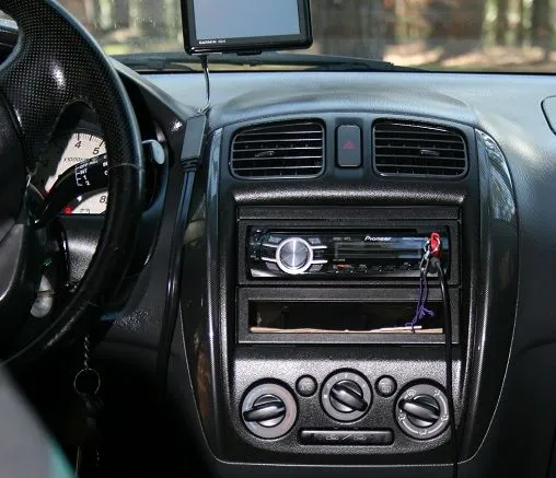

30mpg after my 8mpg Chevy would be a dream! When I got my rig I got an engine code that centered around my cooling, started to check things out and found that there wasn't a thermostat installed! Luckily, it seems, all thermostats go in the same, doesn't matter what car. ... I've actually printed that thing out! I'm hoping to use it to increase MPG and make up for the loss of a tree! Oh yeah, I want your bumper guard, looks really nice with your plasti-dipped rear lower plastic swoopy thingy by the exhaust tip. Can you tell I'm a professional! I used plasti-dip on my console and my window trim, take a look. console.webp
