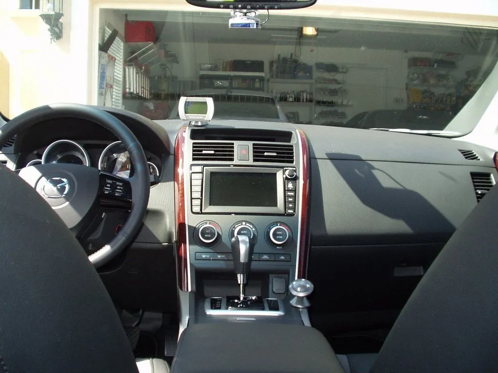

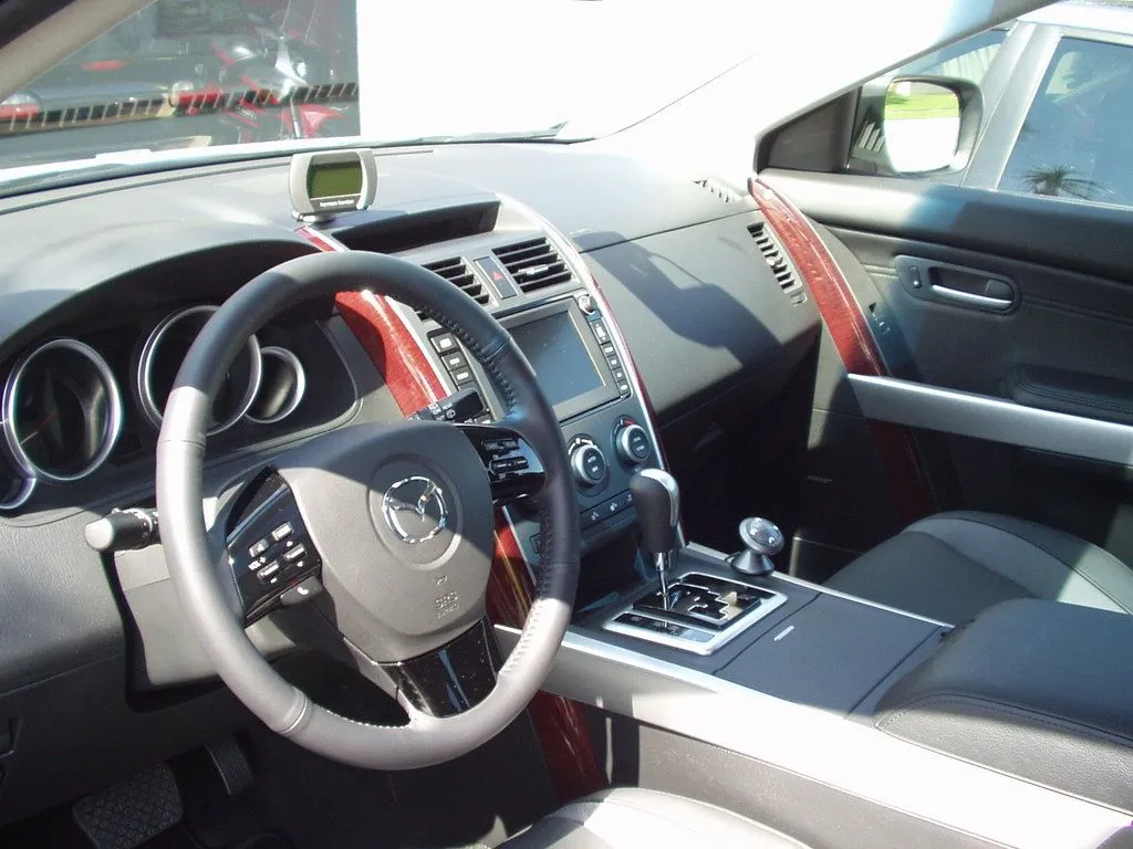

I installed the drive+play today w/the wired FM connection. It sounds pretty good but not as good as a line level connection. I am looking forward to switching to the line level.
to the cig adapter that's switched (under the a/c). It's really easy to tuck in the wire down the passenger A pillar and then under the glove box to the console.
