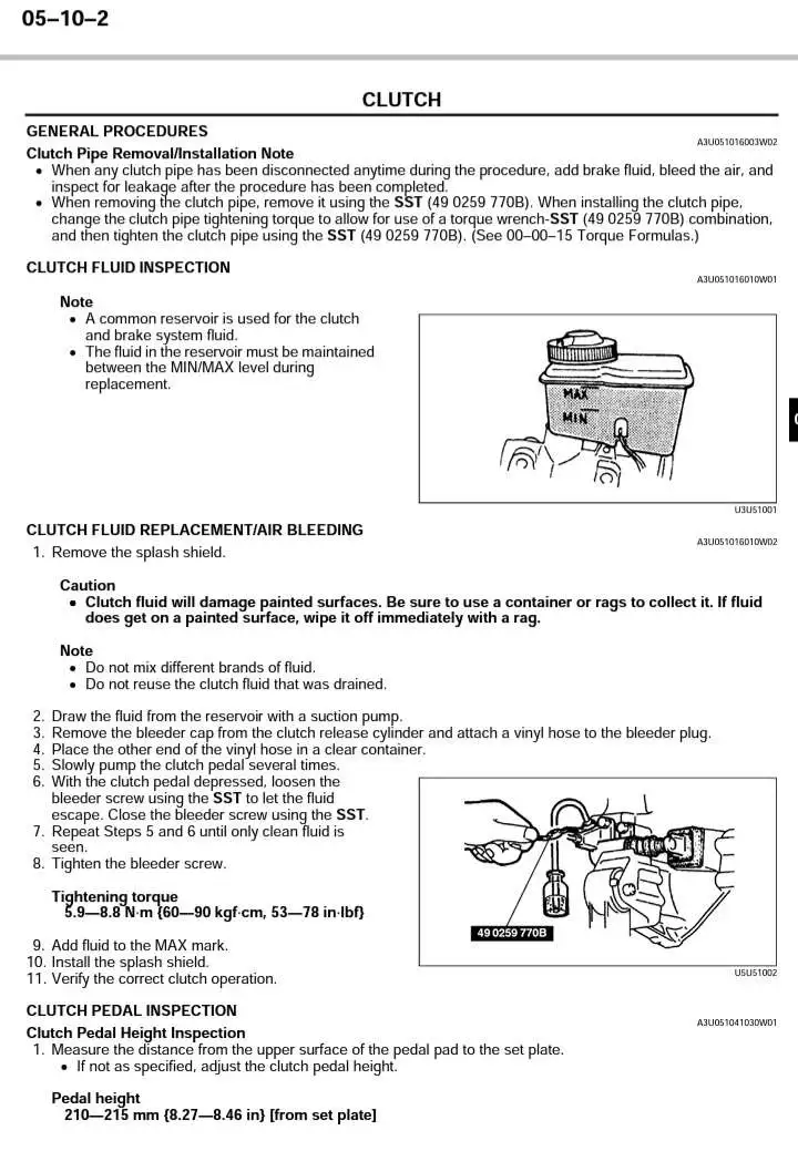

You need to bleed your clutch properly if you haven't.

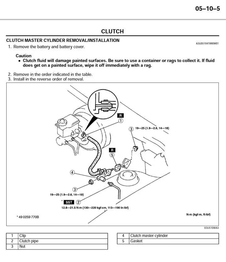

If you've bled your clutch and you still can't get pressure, then you probably need a new clutch master cylinder.
