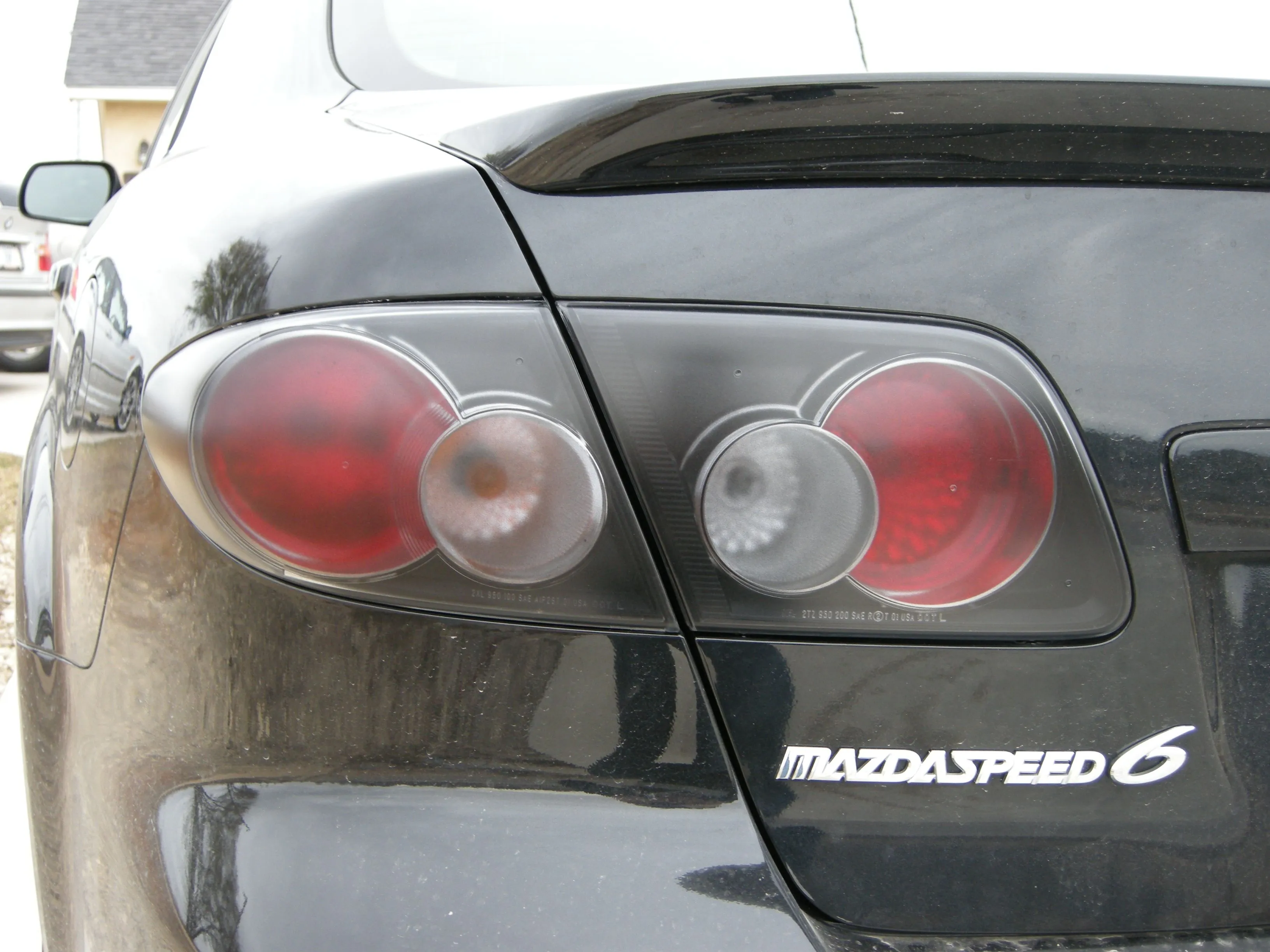

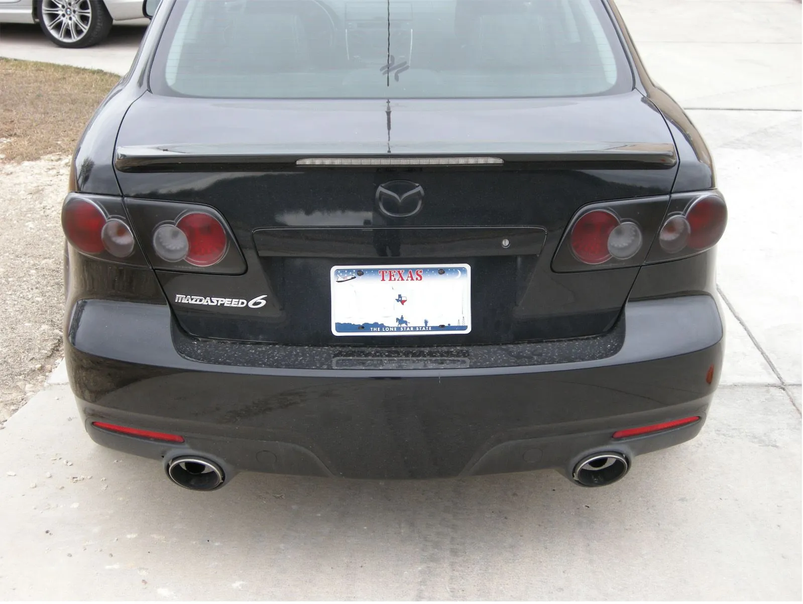

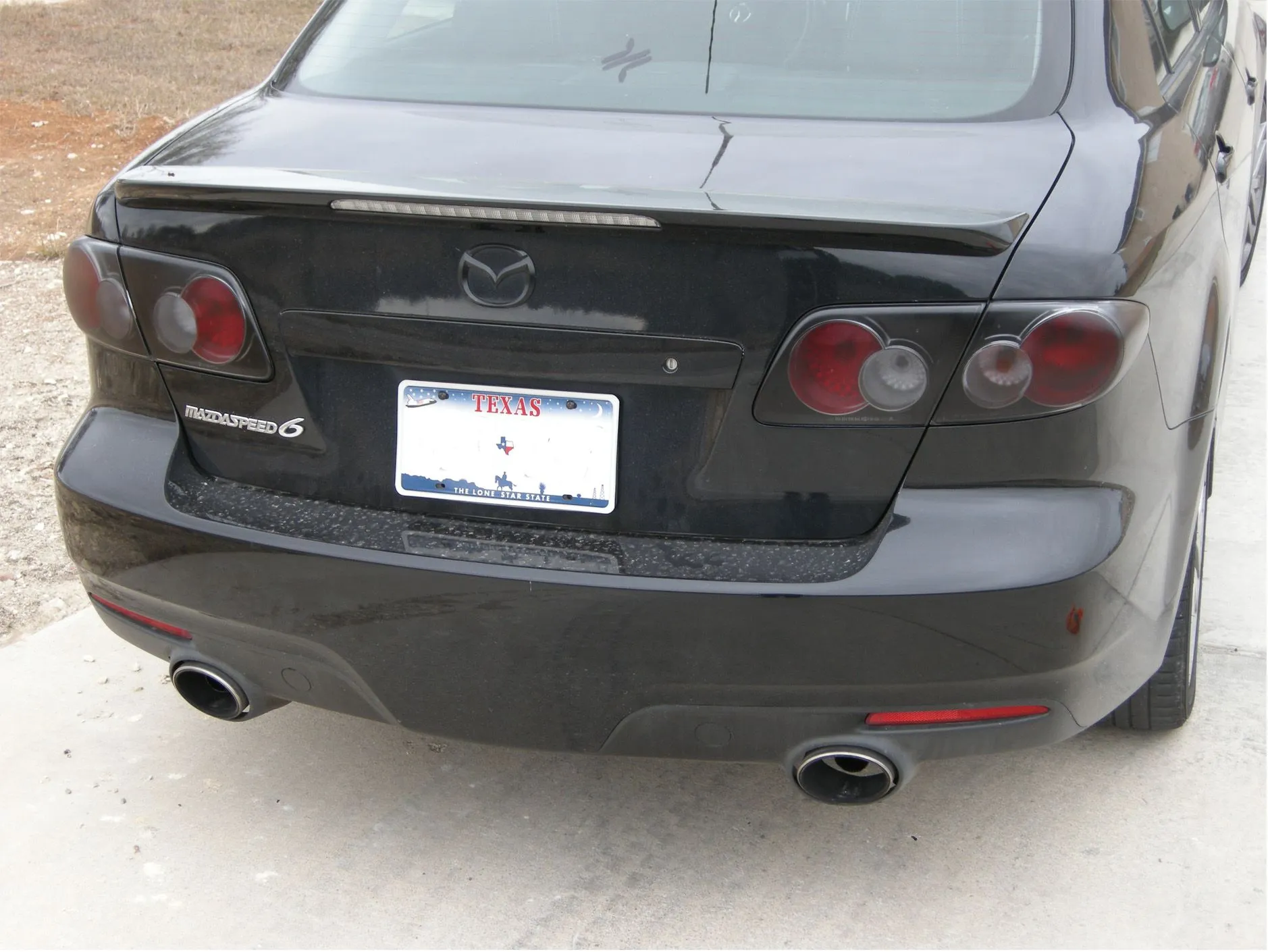

Here are some pictures of it. It may not show it as well, but they just look really matte and smoky, maybe i just need to go darker or something..i don't know.
I know, my car is really dirty.

Looks like you need a couple more thick coats. Almost looks like a mist in those pictures.
I agree with Qwik, I would add 2 or 3 thicker coats and see how it looks. If you do it right you can put clear on and it shouldn't look bad at all. I did a set on a RSX and used clear, and they came out fine.

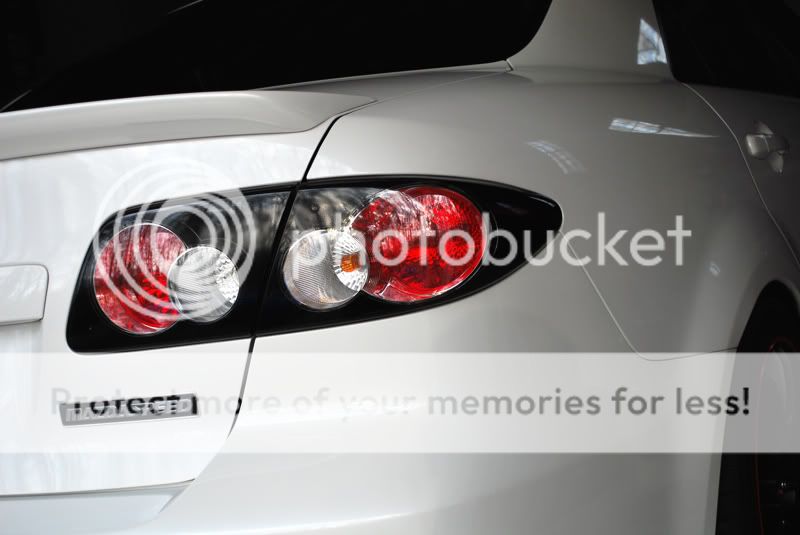

Here goes mine. Not the whole tail just the surround so it doesnt block light output. This was 3 good coats.
