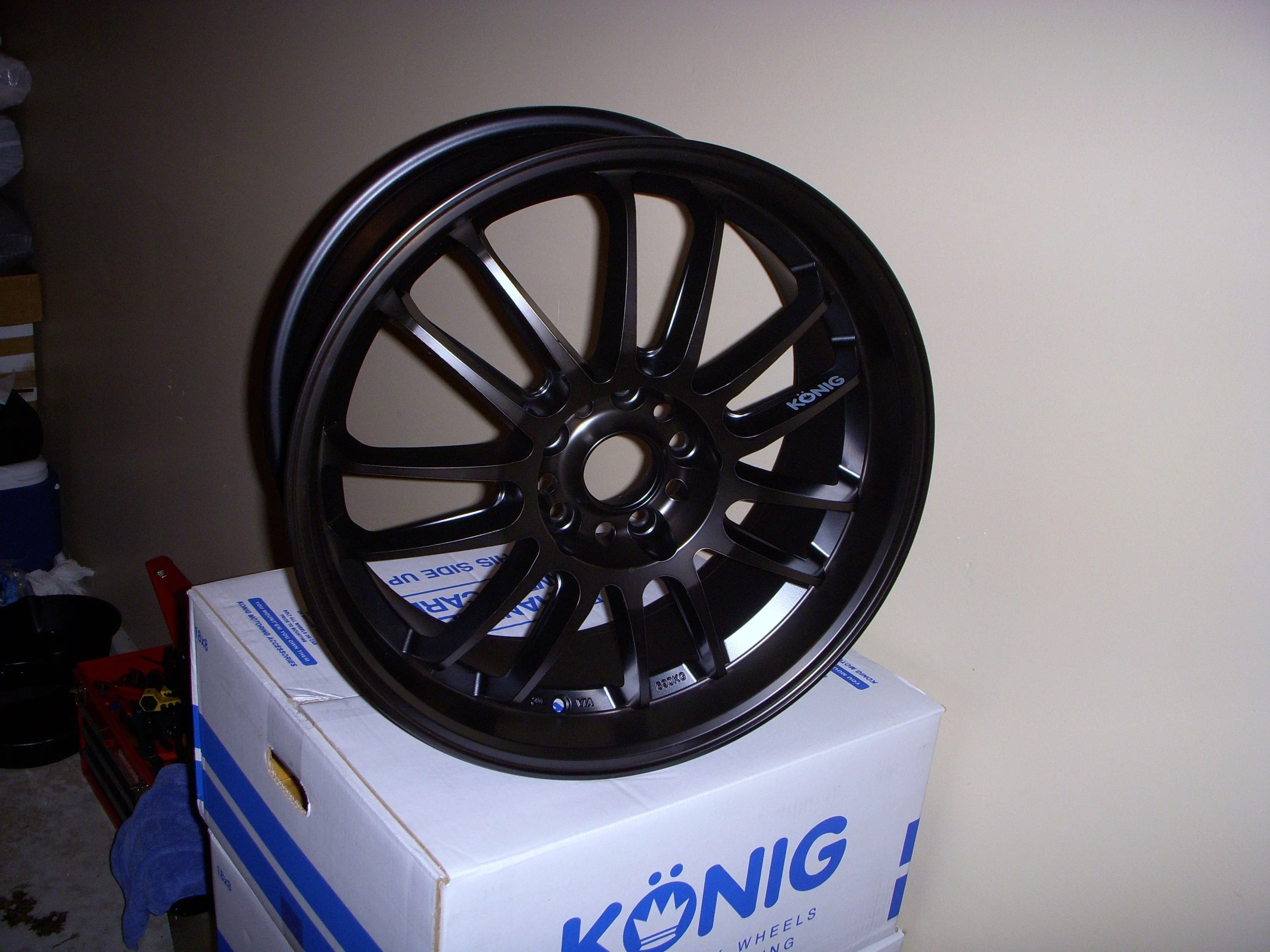

heres couple pics of the wheels. The Hankook's are comming in soon. I just couldnt pass up 488.00 for set of 4..after everything is said and done. It will cost me 1000 bucks for wheels-tires-mounted balanced on my car..so pretty stoke cant wait :)

They look good. Are they 5-114.3??? Perrin website only lists 5-100 available...
your correct..I got the last set of 5x114.3 they had in the warehouse..there sold out now.

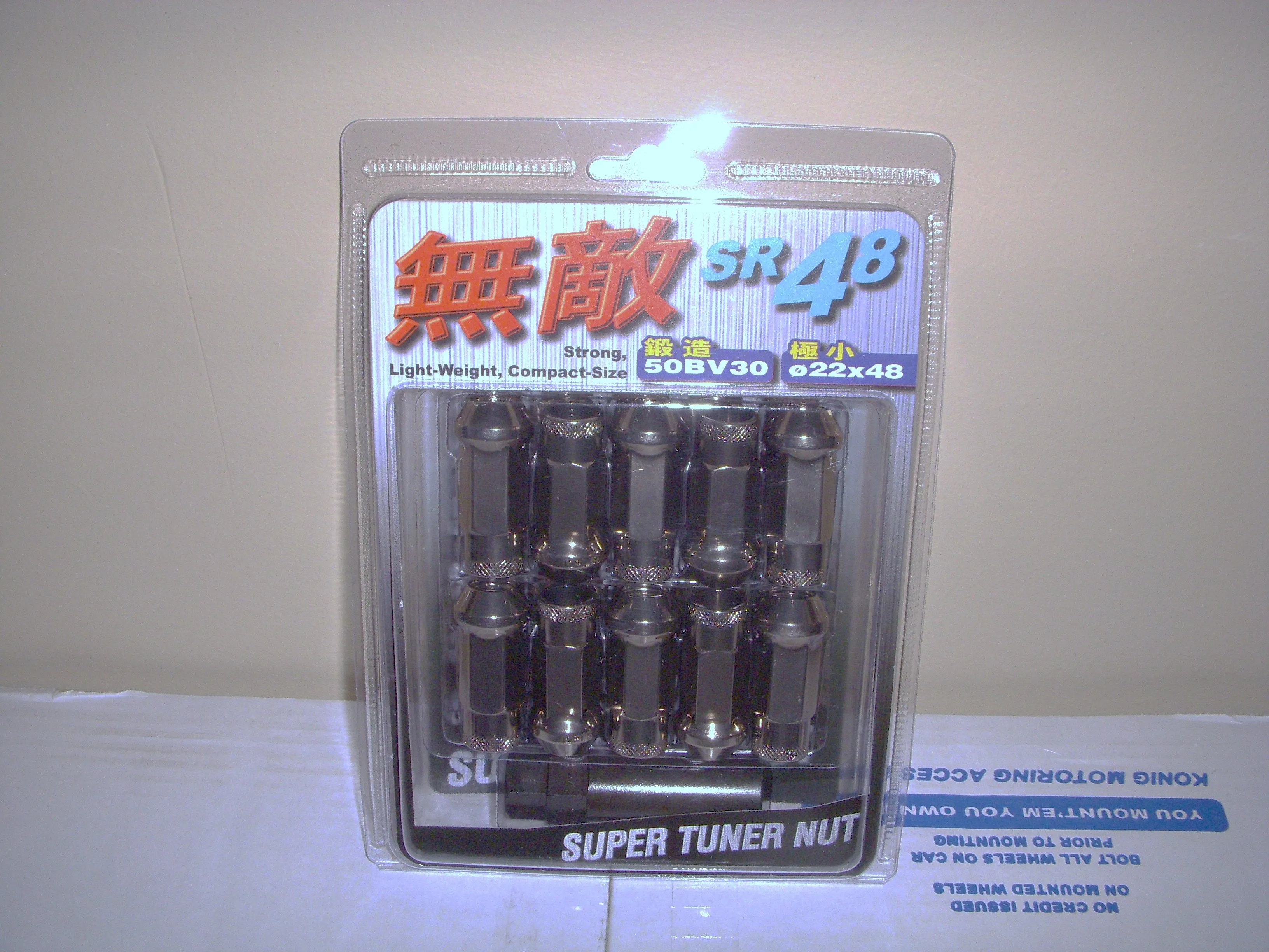

Fedex just got me my lug nuts 30 min ago. So I made a appointment for 230 to get the wheels and tires installed. Pics will be posted soon after. Yeah Im pretty stoked on the deal myself :)

those are probably the ONLY konigs i like. and if im not mistaken light too. somewhere like 17lbs, good stuff... look forward to pics installed.
