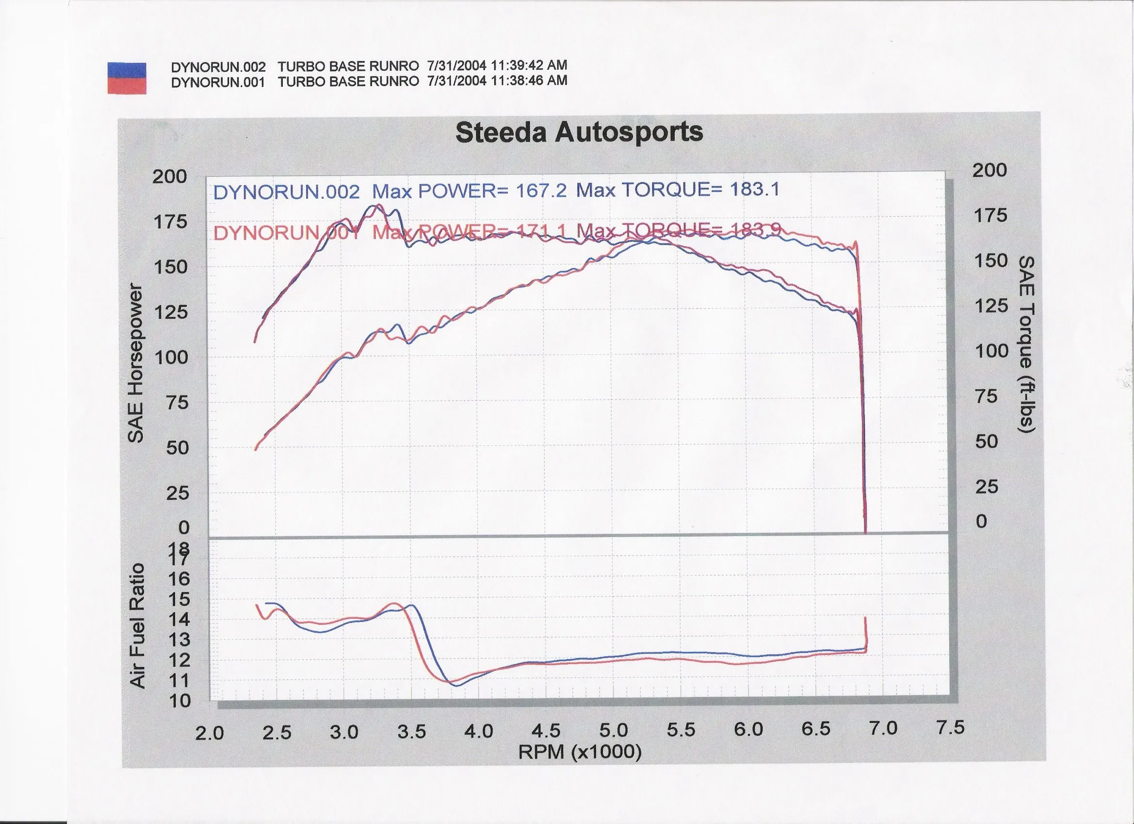

well... i was at the Steeda compound yesterday for the Focus day and they let me participate in the dyno shootout...
The boost settings spiked to about 8.5ish then held strong at about 7-7.5 psi in 4th gear
i have come to the conclusion that my stock exhaust is killing my ability to make power...
I am also finding it irritating how my profec-b spec II is so inconsistant from gear to gear...
1st gear spikes to 9.3psi and then it's immediately time to shift...
second hits about 8.5-9 then time to shift.
3rd gear holds 8psi almost to redline
4th spikes to 8.5 then holds 7-7.5
5th holds 8psi
where's the friggin consistency....
oh well... im not very pleased w/ these results, but then again im not too dissapointed either
